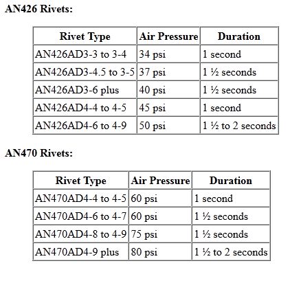

Kenny,
You really need a regulator with a pressure gauge so you can dial in accurate pressures. Start with lower pressure (30 psi) and work yourself up. Here's a helpful table I used when I was building for pressures:
Thanks! Thats the info I was looking for. I kinda figured the tool pressure was too high. I just ordered 2 new air tool regulators from ATS.bullojm1 wrote:Kenny,
