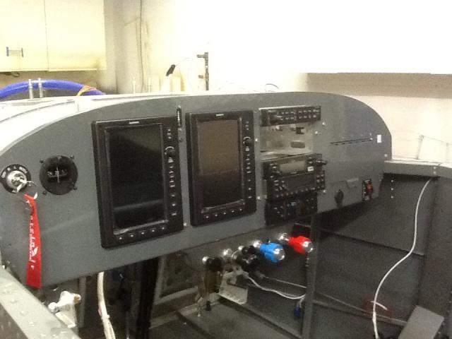

Hey All,
I thought that I would upload some recent BETTER QUALITY pictures! That iPad takes terrible pictures but it is convenient.
Anyways, here they are:
I need to compete the rest of the switches. I will have that placard tomorrow. Once that is installed and a few other things are in place, I should be able to hit the big switch!
Stay tuned!
CJ
Stay tuned!

Hey All,
Stay tuned!
CJ

Craig,
That whiskey compass is just for show. It isn't required but dammit... I like it!
It is very shallow. Perhaps 2.5"?
Billy, I will have you proof read all the placards! Lol
I like the "militaristic" look of the gray and black!
CJ
