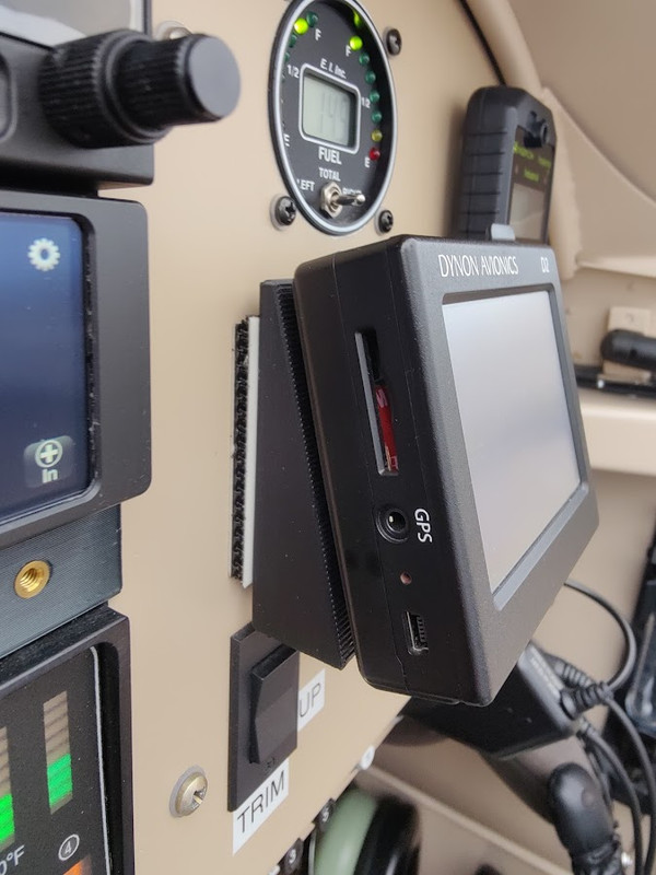

Firmware update did not correct the D2 issue. decided to move on and get a D3 to mount in the same place. I went back to look when I purchased the D2 and it was actually 7 years ago. so, I managed 7 good years from the D2. cockpit heat was probably its worst enemy, sitting on the ramp in the sun. goodbye D2, really OK. the D3 price now is less than I paid for the D2 years ago. drop in place.
this D2 and a 740b wireless failure (repaired for $25) are the only avionics failures in 10 years. I'm not complaining.
hey, the 3M Dual lock has been there 7 years, attaching the D2 mounting block to the panel.

I think I am going to like the D3. no buttons on the top so I can move it around and attach it other places within 3 seconds. is this the optimal solution, no.... but hey. needs some testing in real weather conditions. the D3 is easy to adjust pitch setting, tap in the degree correction by touchscreen. my D2 never needed the external antenna. I'm sure the D3 will be the same, but it needed the external antenna in the hangar to find itself.

D3 test flight was good. not head banging bumps but close. D3 was secure and reading steady. the difference between the mounting angle for these locations is 16 degrees. I set 21 degrees on the panel wedge and 5 degrees when under the glare shield. once you reset the install angle it takes a couple seconds for it to adjust itself. note: is only reads GPS speeds and altitudes and does not require any connections except power. if it is the same as my D2, it will operate on the battery for 6 hours, I tested it. if you are landing into the wind, you will always be fast thru the air using GPS speeds. I like it for the passenger, and it is a simple attitude backup. two for one. my major avionics upgrade, shipped in one day. :)
