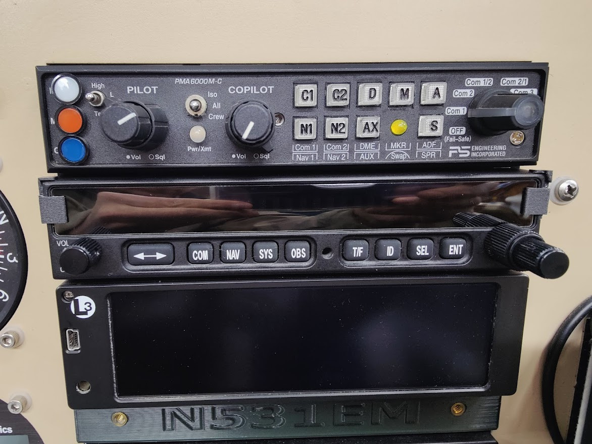

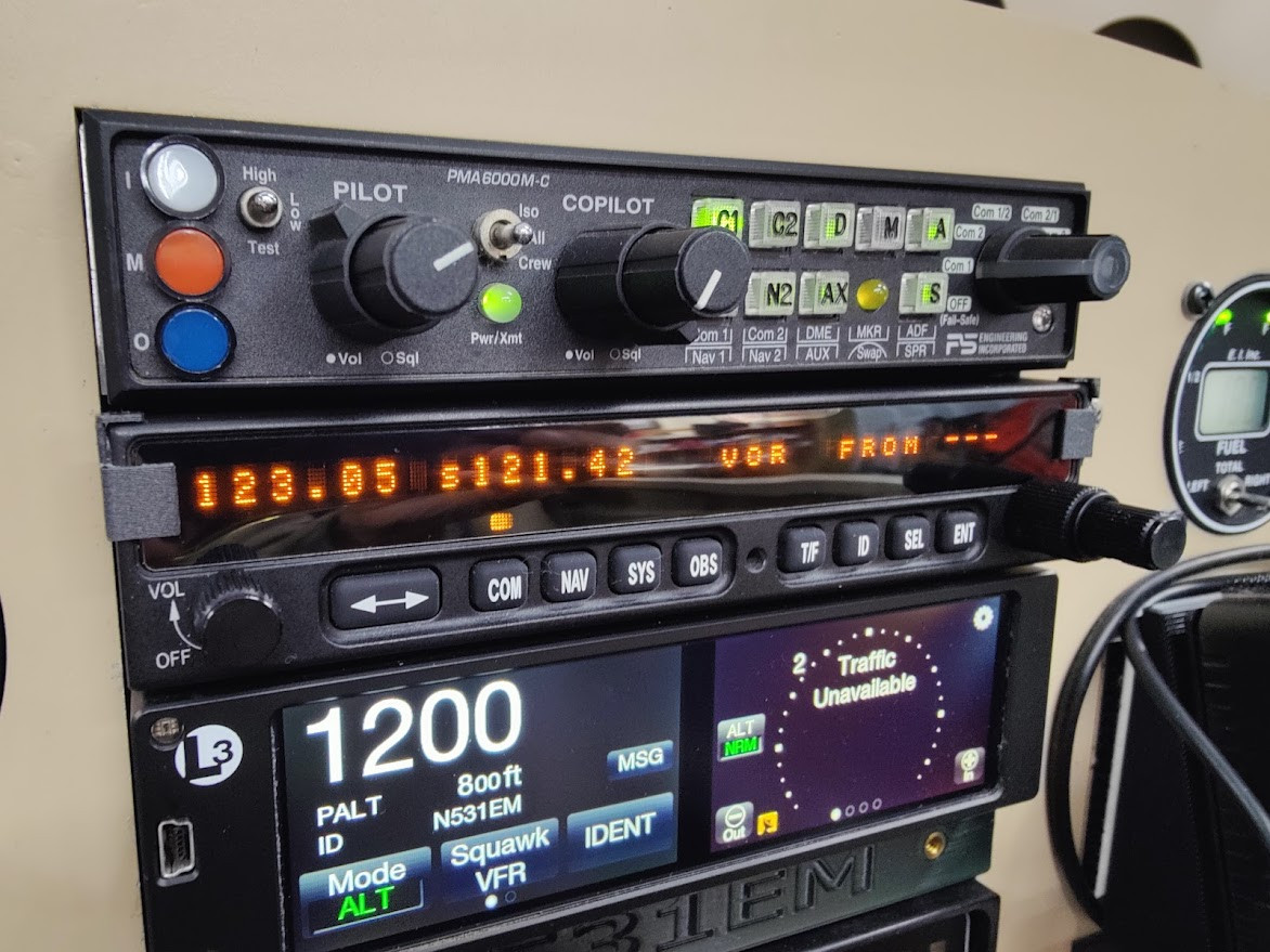

After 12 years, my SL30 plastic faceplate has completely come loose, so I’m going to try a mechanical attachment.

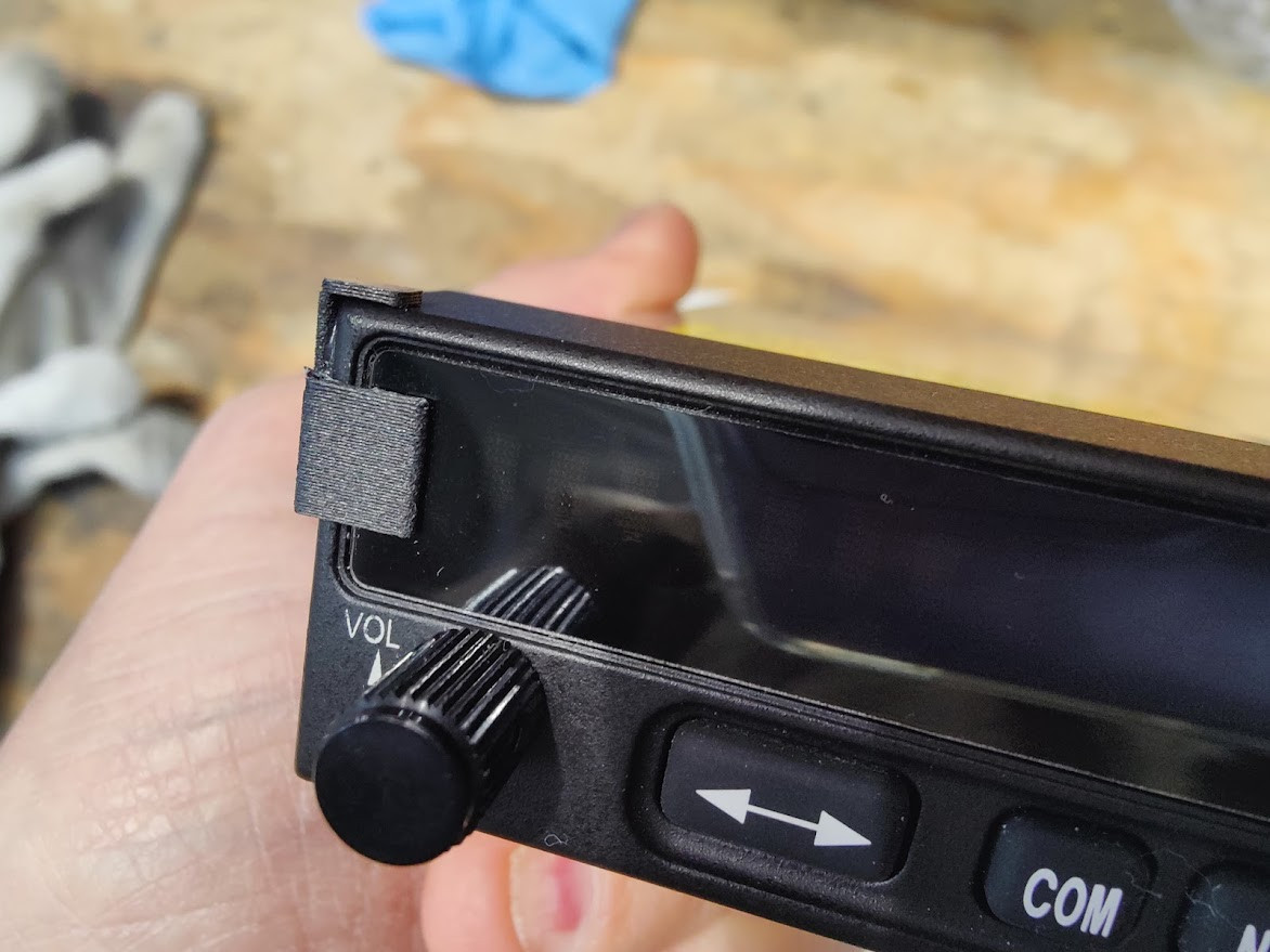

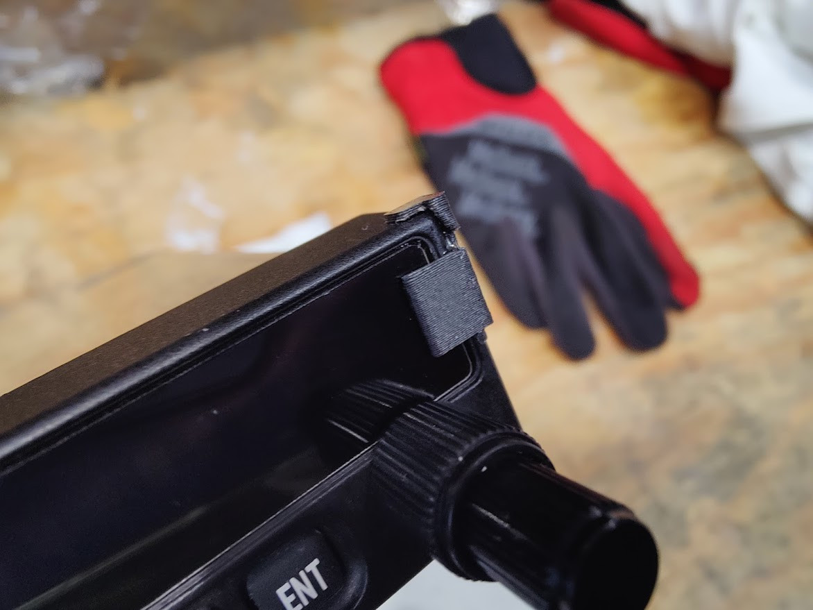

small and thin nylon carbon fiber parts....

It’s a snug fit, and I hope it’s the last time I’ll need to work on it. I used G/Flex epoxy, and added a small gusset on the right-hand side for extra stiffness after breaking one off during the plastic cleanup preparation. That little gusset helped a lot.
