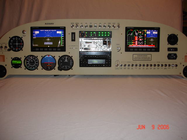

Now, this is Garry's panel:
He is known as rv9pilot on the VAF forums. When I saw this setup, I thought he read my mind! It is the setup I have always been planning on. It is good to see it all fits in the space provided with room to spare!
I may swap out brands on the EFIS displays (and probably will) but in a nutshell, it is the best I have seen yet!
Do you agree?
CJ

CJ -
I saw that today too and really liked it.
The glass panels are well laid out - and the Trutrack Pilot 2 appears to be a great back-up instrument.
Having the bank of switches on top results in giving more room for the instruments below.
The only thing I thought could be improved was the Magnetic Compass is too far away and the parallax may be a small problem.

True about the parallex effect of the whiskey compass. I thought about that too and would put a DG to the left of the airspeed indicator. In a partial panel situation, it would be better there to aid in confirming wings level.
CJ
