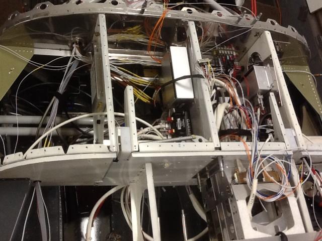

Here are some updated pictures:
Lots of loose ends that need to be tied up!
The pressure sensors!
Coming along!
:roll: CJ

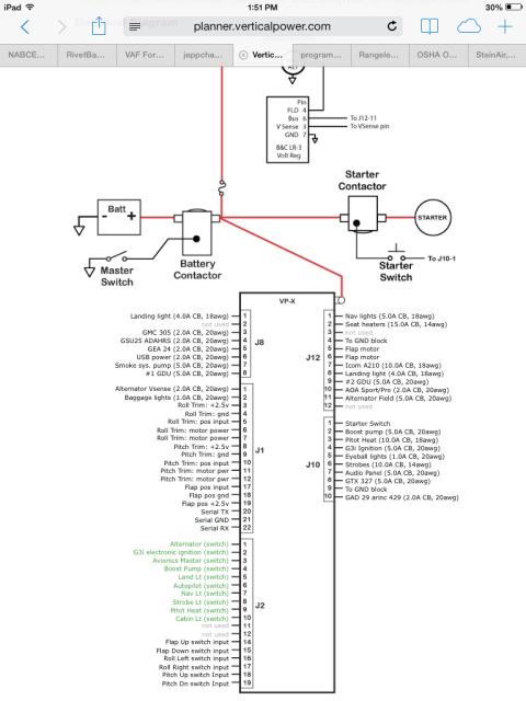

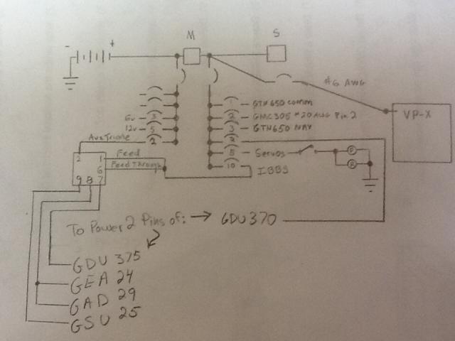

All, here is my power plan:
What do you think of this design?
The 6&12v circuits are power plugs.
My goals are:
1) To use the IBBS minimally on start up.
2) To have the autopilot and nav/comm 1 optionally available in the event of an alternator or VPX failure.
3) To utilize the reversionary capability of the GDU screens by shutting off the master (GDU 375 will become the PFD, right?), achieve maximum battery autonomy from the IBBS and then only if necessary, turn on the master for more endurance and manage loads as required.
Am I on the right track?
This isn't too hokey, is it?
Should I put the GDU 370 PIN 2 on the IBBS as well?
I didn't see any reason to have the GMC 305 pin 2 backed up without the servos as well... So I gave them power too. Why does Garmin do that?
What are your thoughts?
8) CJ

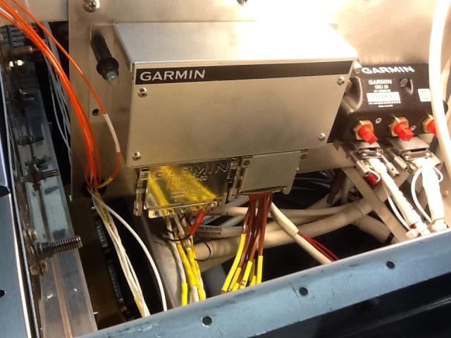

Pinning out the VPX has proven to be interesting. I am leaving some extra wire prior to the terminations for a couple of reasons. One is so that they can be serviced a bit easier and two being... Well, who knows what the future of electronic circuit breakers will be!
This is the GEA24 engine analyzer "brain box" if you will.
This was my first attempt at wiring D-Sub connectors. I think it will work!

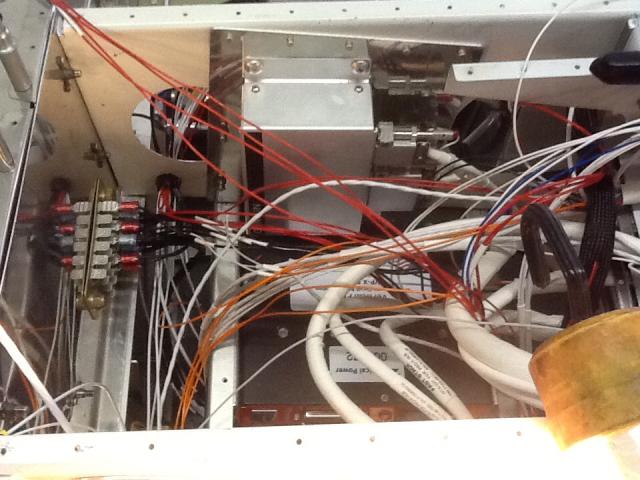

Here are the cables as they pass the firewall and get routed through the ribs.

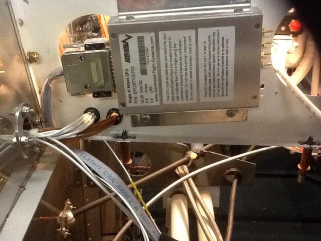

I think this was a good place to home the AOA brain box.

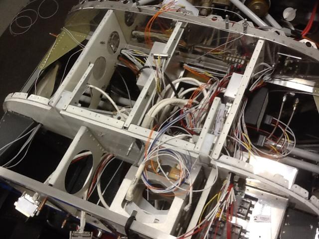

This bay is getting busier!

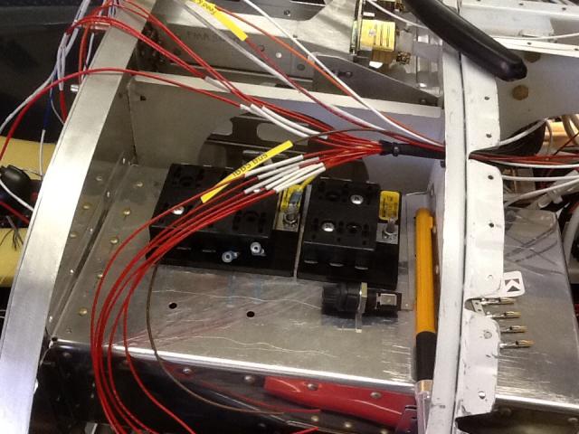

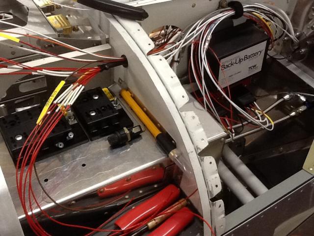

I really like having the fuse blocks on the map box.
It will keep them visible and serviceable!
One is for the "Secondary bus" that feeds the GTN650 and the servos. The other is for distributing the backup battery loads.
I will use the single fuseholder to protect the backup battery trickle feed.
Hard to tell from this pic but it is coming together!
I gotta say, this part is fun!

I looked at your electrical diagram and read the posts that follow. Am I missing something, or not reading it right? I don't see on your diagram that anything goes into or out of the VP-X, except the power cable. And then you have fuses on top of your map box. If you bought a VP-X, what are the fuses for? Help me understand what you're doing. :?
I put a VP-X in mine, and I won't have any fuses that I know of (at least not yet, I'm far from being finished).
I'm just a little ways behind you, and learning fast! Like Antony, this has been the most intimidating part of the whole project so far for me. :o I'm not a geek!
Bruce,
Here is a screenshot of the online VP-X configuration tool.
All the loads shown here will be fed from the VP-X.
I have a 6 circuit fuseblock that will serve as a distribution center for my IBBS Backup Battery.
Another fuseblock is intended as a backup to my VP-X and feeds the backup pins of the G3X components via the IBBS. It also feeds the 650 nav/comm and the autopilot servos. In the event I should lose the VPX, I should be able to sustain flight with this design.
I have a single fuse that is always hot, directly from the battery and it is a 2 ampere trickle charge for the IBBS.
Does that make sense?

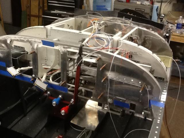

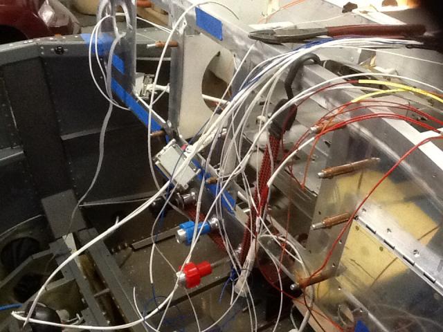

Btw, here is a few current state of affairs pictures...
Still need to neaten things up yet but you get the picture.

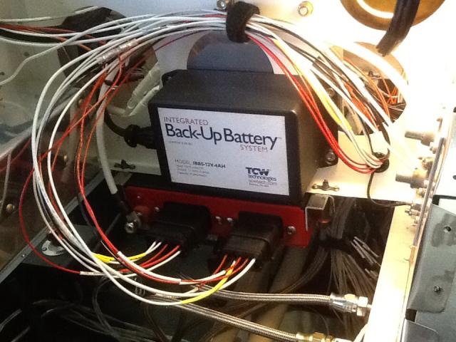

Well, keep in mind that the IBBS serves another purpose besides maintaining the screens during a "plan C" scenario.
It also boots the system and maintains it throughout the startup sequence.
You will want (need) your screens alive for engine instrumentation during the engine start. In addition to that, the possible voltage dip during cranking might cause the screens to reboot if you don't have a backup power source.
This is all provided for with backup power.
