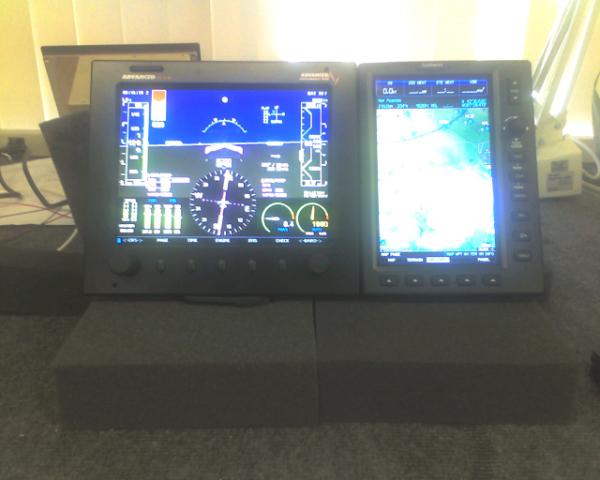

Brett you turkey ...
You gave me a picture today of something I have been considering. This was either a very bad photo or a very good one, I am not sure I have decided yet. My biggest issue with the AFS EFIS displays was that I did not like the way they overlaid the HSI on the AI. This picture today really got my hopes up.
