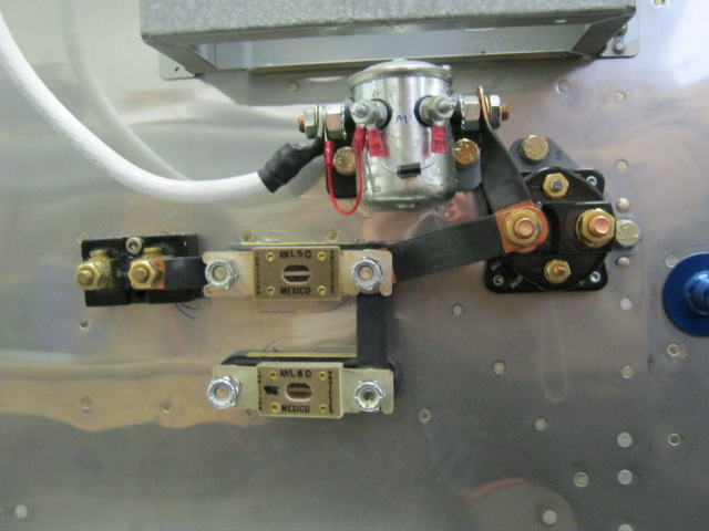

The method I used was first to wire the master relay and all of the buses. I would consider this the "foundation" of wiring. Check that all of the buses work with the proper switch throws and possible failures. I ended up with 5 busses - Battery Bus (always hot), main bus (hot with master on), E-Bus (See the AeroElectric Connection if you don't know what this is), Avionics Bus and a Backup Battery Bus.
Once this was done, I wired up one component at a time and then tested it. Once the bugs were worked out, I would move onto the next item to wire.

Bruce, I (like Mike) started with the contactors and battery box.

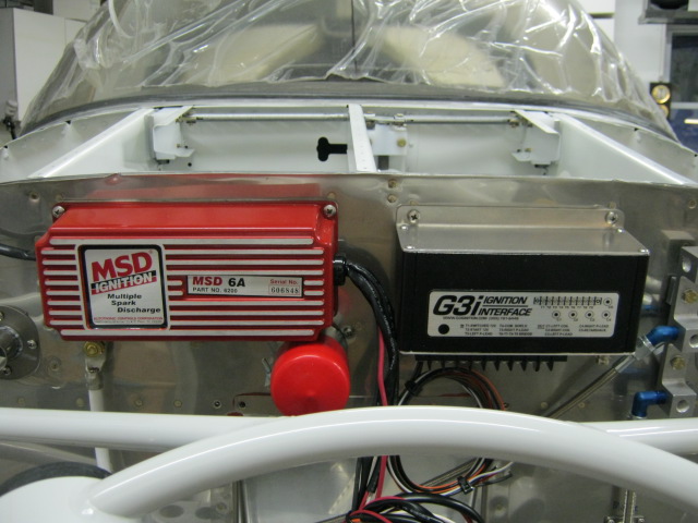

I just installed the G3i modules.
Hey CJ,
Could you please explain, in simple english for us electronic dummies, what those red and black boxes are for? I don't think I've seen 'em before. Thanks! :)
Bruce,
Those boxes "wake up" my Slick mags and make them a pair of electronic ignition mags.
If I lose electrons, they revert to standard mag functionality.
How is that for layman terms?
:wink: CJ

captain_john wrote:Bruce,
:wink: CJ
Or, they just make the engine go better? 8)
Or they restrict Lycoming's wonderful method of turning cash into noise? :o
btw, mine are almost in the exact same orientation on my RV-10, excep ton the cabin side of the firewall.
