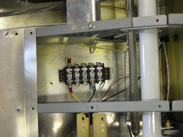

MTC. I ran out of space on my ground block also on the firewall. At the point that I ran out of space I was wireing for the wings and tail so I constructed another ground block and mounted it in the center section under the seat area then ran a single wire of proper gauge to the firewall for the ground. All of the grounds for all of the equipment go to the firewall ground block and then directly to the battery.
smithhb
Posts: 365
Location: Blue Ridge, GA
Post by smithhb »
I did the same thing. I used the block for my NAV lights and strobes. Good thing, too, because I couldn't squeeze another wire through the spar center section snap bushings!
