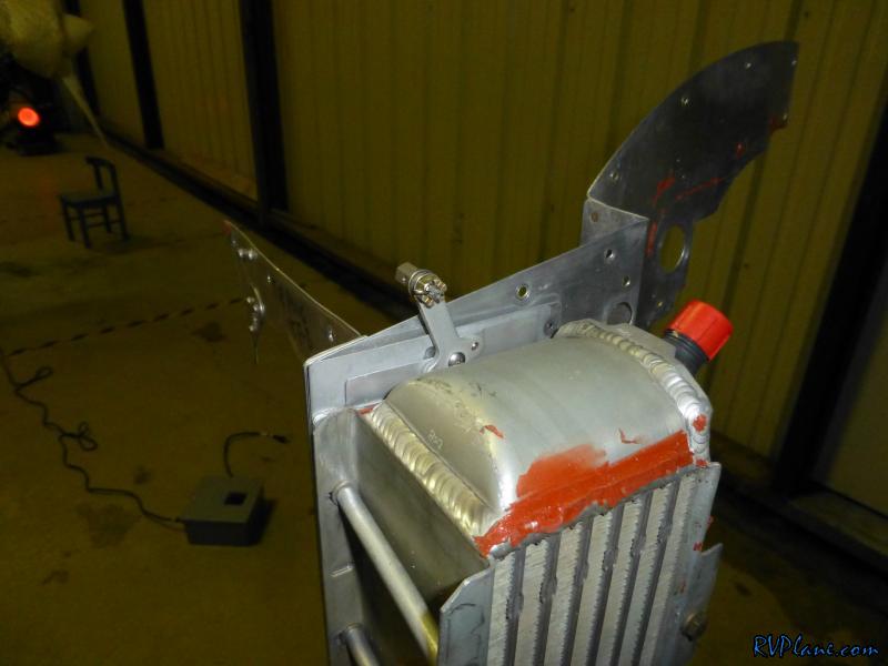

Bruce, yes, I did have to flush up those rivets on the aft side too. However, my cooler is a different model. I sourced mine yellow tag from Pacific oil cooler. Here is a picture of it while I was mocking it up.
Oddly enough, it is mildly leaking right now and I need to send it back but don't want to suffer the downtime!
I have a loaner that looks like yours. Is it the Vans cooler?
I might put that one in to get me by or keep it installed if my temps are okay.
I did have to trim the actuation arm, as it interfered with the cowling.
I hope this helps!

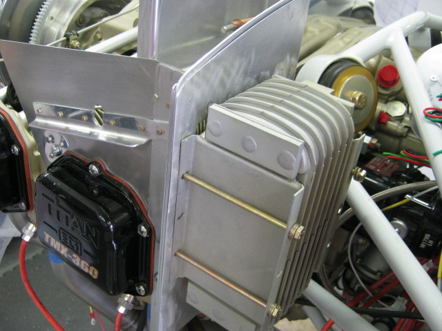

Project completed!
Post by bruceh »
Off with the flanges using the dremel cut off wheel. I filed down the cuts and smoothed off the edges.
I match drilled the shutter to the baffle and gave it a test fit. The rivet heads at the top of the baffle would interfere with the movement of the shutter blades, so a regular AN960-10 washer will need to go between the baffle and shutter.
The aft part of the shutter needs just a thin AN960-10L washer between it and the oil cooler. The oil cooler bolts need to be longer. I bought some AN3-44A size and this was perfect. I also used a single AN960-10 under each of the long bolt heads.
The B-nut that Van's sells with the oil cooler shutter interferes with the aft baffle skin.
The aft-most baffle skin can be cut away, since the baffle seal is forward of this skin.
Another quick set of cuts with the dremel cut off wheel and some filing. Now the B-nut has plenty of clearance in both the on and off position of the shutter.
The worst part of the project was punching a new hole in the firewall for the cable control. It took a bit of work, but I got the control cable drilled on the panel, run through the firewall and up to the shutter.
I did a lunch flight today and the OAT was about 60F at altitude. The oil temps were barely pushing 175F with the shutter open. I pulled out the control knob just a bit and was able to control the temps nicely to about 185-190F.
I took more pictures of the finished project, but left the camera at the hangar. Look in the Phase 2 gallery on my web site in a few days to see the rest.

Last few photos of the installation:
The worst part of this project was getting under the instrument panel, drilling a new firewall hole for the control cable and installing the eyeball pass-through. I used my Harbor Freight 1 1/8" punch set, then drilled the remaining 6 holes for the eyeball holder. Drilling stainless steel is a real pain. Once the holes are created and deburred, getting my hands down there to tighten the tiny screws was a real challenge. The control cable comes up to the engine mount around the oil filter and across to the shutter.
An adel clamp holds the end of the control cable.
I put the control knob next to the Cabin Heat knob. I need to get a decal made up for this control. Currently just using a post-it note as a placard. I did a flight up to Camarillo with my wife for a Tri-tip BBQ lunch. I messed around a bit with the control and it seems to work effectively to increase the oil temps.
