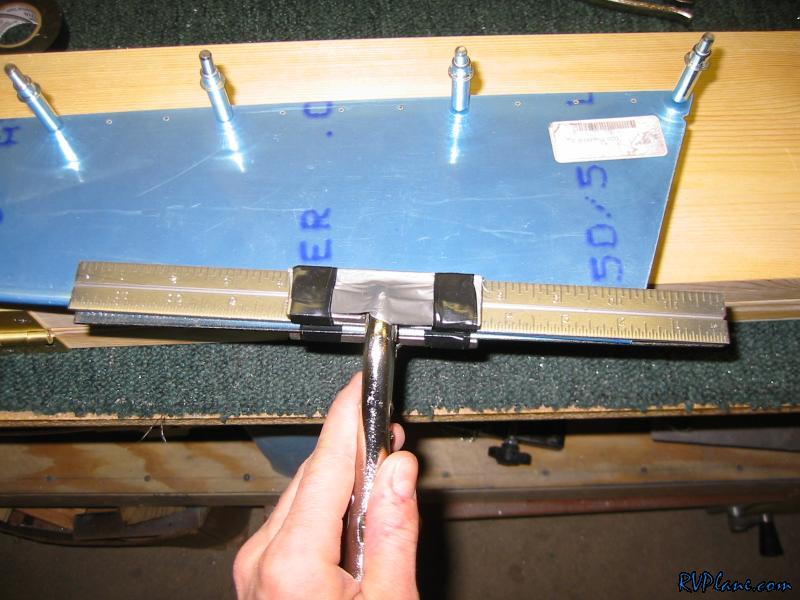

You can use the trick of the hand seamers to smooth out any waviness in the trailing edge (if you get any). However, you want to put a metal rule on the top and bottom of the hand seamers or else you will hand some nasty results. Here is a pic of my hand seamers with some metal rules taped to it to show how it is supposed to be done:
