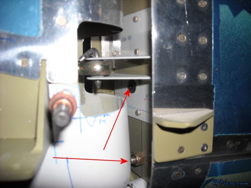

Hi all,
I have my rudder mounted (RV_7A)and rigged but, I noticed one thing is missing. There is no hole for running the wires to the tail nav light/strobe light assy.
Did I miss it or is this ad-hoc? Where is the best place to locate the hole in the verticle stabilizer aft spar?

Hi Ed,
Here is where I passed my wire through:
http://rvplane.com/showthumb.php?picname=DSCN1052.JPG
And here is the page describing how I did it:
http://rvplane.com/?categoryid=7&dayid=911
Hope that helps,
I punch a hole below the lower edge of the VS spar. This way the rudder and VS could be removed without pulling any wire. I can snap a pic tomorrow if you need it

In my 9A, I put a connector inside the rudder fairing so I can pull the fairing, pull the plugs apart, then pull the rudder. As far as routing the wiring through the VS, yeah that's pretty much ad hoc.
