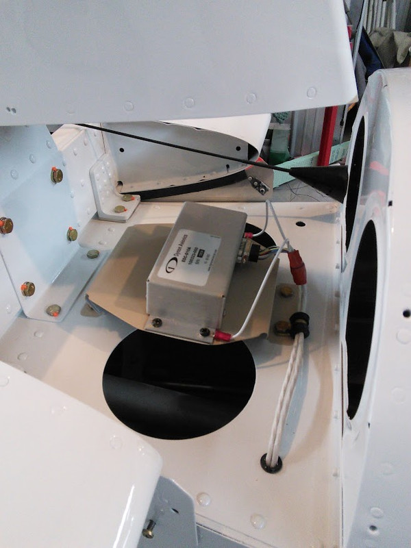

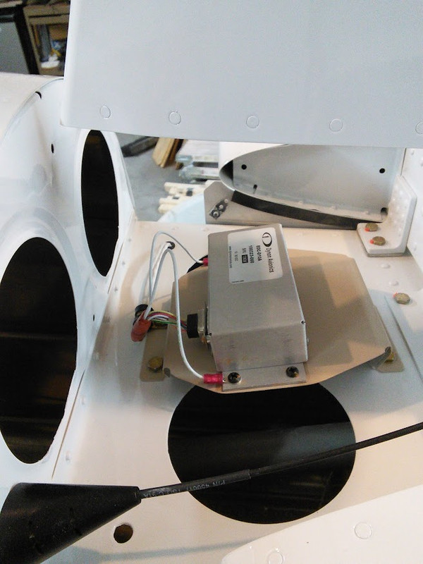

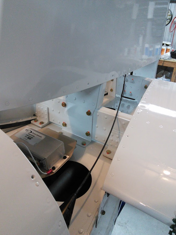

Where is your ELT antenna?
Posts: 2120
I know some put the ELT antenna in the baggage compartment or on top of the fuselage. I decided to put mine under the intersection fairing. the sending unit is mounted with the Van's mount just aft of the baggage aft bulkhead.
