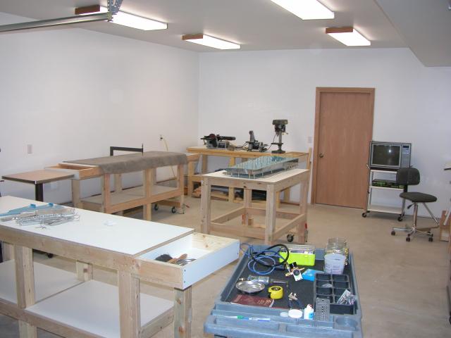

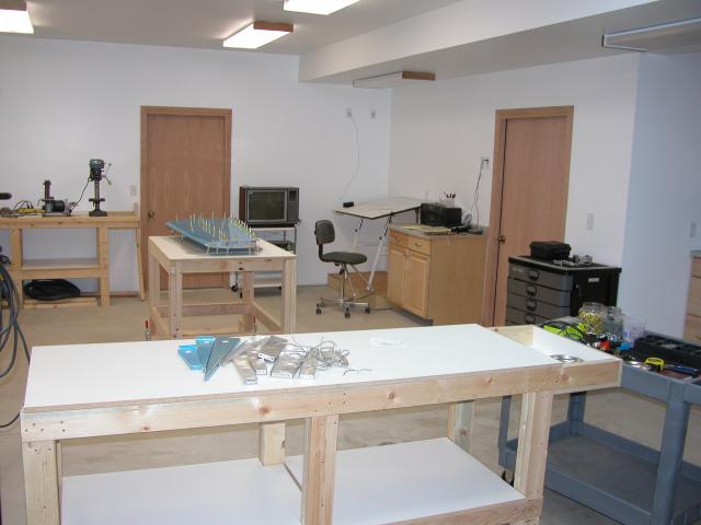

Main shop details:

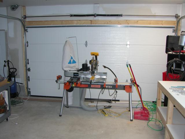

About 800 Square feet of heated and air-conditioned space with access to the outside with a service door and a 14 foot overhead garage door that walks out to grade. Lighting consists of over 2000 watts of florescent lighting that is individually switchable depending on the work area. The ceiling and walls are white. My eyesight is not what it used to be so I like a lot of light.
(The only "Shadow" in the shop is the cat. (Named "Shadow")

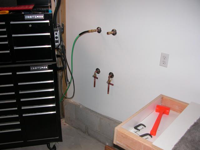

Main shop has two hard line compressed air lines in the walls that go to a compressor remotely located in a sound proofed room. Two lines that can be independantly regulated off site to prevent accidental adjustments. Main shop is sound proofed in the ceiling with 18 inches of insulation and sound board to save my youngest (who has some developmental challenges) from loud riveting noises when he is upstairs.

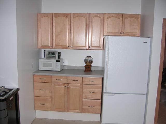

Main shop houses a fridge (for adhesives only of course :mrgreen: ) and dry bar (to put adhesives on when not in the fridge...).

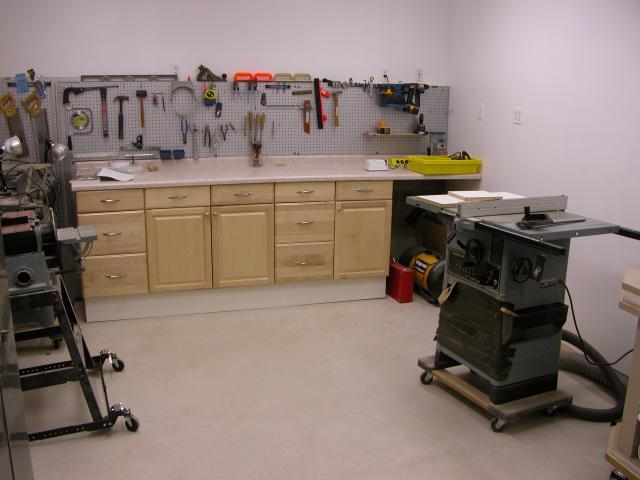

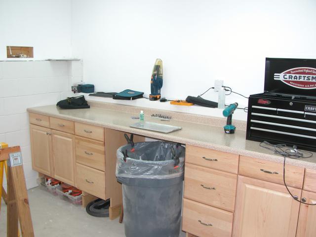

Wood Shop Details:
Separate wood shop to keep wood dust and house-hold projects out of the main shop. Three in-wall air lines tied to remote air compressor located in other utility room for noise control. The slop sink is in this room. 14 chest high outlets spread over three different 20 amp circuits. 1120 watts of lighting in this room. Work bench 4 inches higher than standard height (I am 6'03'' so this is a more comfortable height for me)

Approx 140 square feet of seperate shop space for handling chemicals and paint. 300 cu. feet/min. exhaust fan in ceiling to exhause fumes out of shop. Air line in wall to remote compressor.

Each work bench I made I ended up making changes to from the last design. First one was straight EAA. Second had a set of wheels on the end so I could pick up one end and move it around "wheelbarrow fashion." I also added a tool tray on one end. Newer ones then had four swivel casters with lock downs on the corners and another tool tray. My crowning achievement is the C-Frame tabel with removable insert to set the C-Frame in and a removeable carpeted top... tool trays on each end and wheels. (I tend to have everything on wheels to make the shop more flexable, and to allow movement of the tool to the work.)
