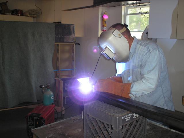

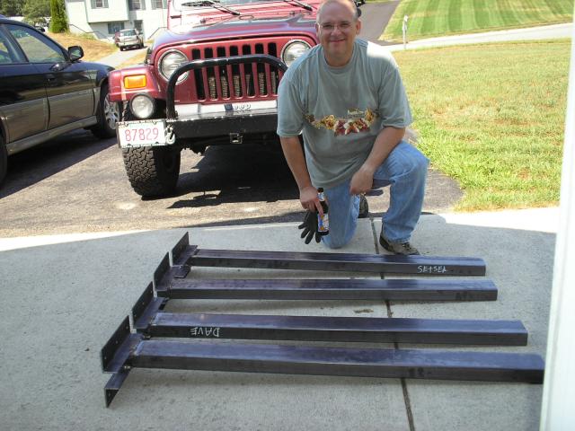

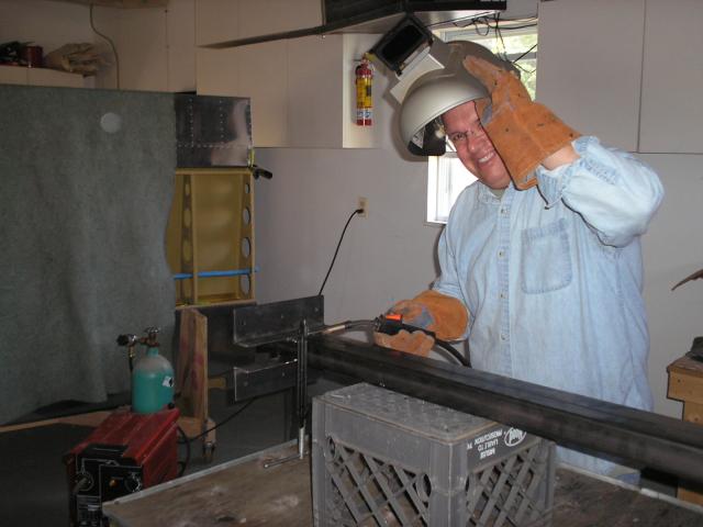

Yesterday, Thermos came down to my shop and brought with him all that was needed to fab up the infamous "Rudi Geryling Wing Jig Stands".
Cover me, I am going in!
Zzzzzzzzzzzzzzt, zzzzzzztttt, sizzle, POP! (sound of eggs cooking)
VICTORY BEER!
Thermos did all the prep and welding himself and can't wait to weld something else together!
:mrgreen: CJ
Sweet!! 8) 8) 8) Way to go guys! Looks wonderful! Now...pick a good color!

Captain John is a great teacher...I had a blast learning how to do MIG welding (what's the right term, John?). Those victory beers were especially tasty! :drink: :drink: Now if I could just get the rest of my shop rebuilt and start sealing some tanks...

I need a set of those, when are they being shipped? :mrgreen:

Themos, CJ, I am about to fab those too :)
I asked Chad, and he said 1/8" thickness for everything. Is that what you guys used? Also, what size tube steel and how long did you go with?
Thanks
Will
7A 72452 Wings
\_____@(")@_____/
Thermos
Posts: 328
Location: KASH
Post by Thermos »
Will,
Yes indeed, all the material is 1/8" thickness. The uprights are 2"x4" structural tube, 54" long - the feet are 2"x3" angle, 10" long. You might be able to use thinner material, but the 1/8" stuff is pretty sturdy. Those jigs should last through several sets of wings!

Thanks Thermos! I see that you used Rudy's demensions with the max height.
Thanks again!
Will
7A 72452 Wings
\_____@(")@_____/
Thermos
Posts: 328
Location: KASH
Post by Thermos »
I did? That was purely by accident...great minds and all that. I just built them to the same height as the temporary wooden jigs I had in my previous shop.
