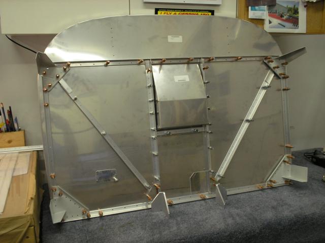

Anywhoooo, I should qualify that statement that these saws work well in firmly supported thicker material (0.063" and thicker)! You wouldn't want to use it on thin material. But, for doublers, angle and baffles it IS the ticket!
I have visions of making my baffling out of thick stuff and using the jig saw to cut it. The common thought is that the Van's baffling kit is too thin and prone to cracking and what not.

It worked well on the 0.063" doublers and gussets.
