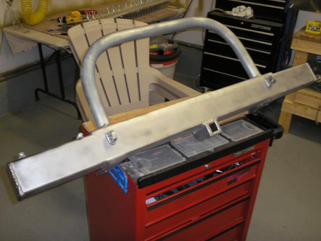

The test bed is this JEEP bumper I had made over the past year. It is pretty cool. I couldn't buy one with all the features I wanted, so I built it my damn self! It holds air, has 4 lighting tabs, a Reese receiver for maneuvering my boat into tight places, a winch plate and is WICKED BEEFY!
I figure this environment is much more demanding than the interior of my plane. It is a ferrous substrate, in a salty environment that is also subject to mechanical damage.
It doesn't get much more demanding than that!
I sandblasted (or more accurately, the kids did... credit where credit is due!) it today, will scotchbrite the holidays and solvent clean it next.
Saturday afternoon, I will hit it with DuPont VariPrime and then apply the top coat, Nason Ful-Thane!
Thermos is coming down to help me and maybe a couple of other builders will join in on the process!
I will keep you posted as to the quality of the application and the subsequent durability!

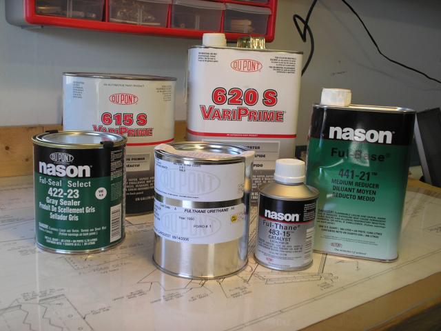

I learned some stuff about painting today and if you are interested in listening, I will tell you what I learned.
We all know that VariPrime is not a "sealing" primer and that it is porous. Does anyone know what that means or the impact that it has on the material? I didn't until now.
The fact that it does not seal means that, if TOPCOATED it will trap air under the NONPOROUS urethane top coat and bubble/blister.
This means that we need to SEAL it before topcoating.
My steps are as follows:
1) Media blast the bumper. This removes the mill coating and generally cleans it up.
2) DA sand with 180 grit to create an adhesion profile.
3) Solvent clean the material to be coated and suspend it for coating.
This allows me to fully access the entire component for even coating.
4) Prime with a self etching primer. I am using DuPont VariPrime.
I ran this past my buddy who is a coatings guy and he says I am on the right track. That was comforting.
I want to eliminate the sealing step for the cockpit, so I will be looking into Primer/Sealers for that when the time comes around. Until then, this should prove to be an interesting experiment!
Wish me luck!
CJ

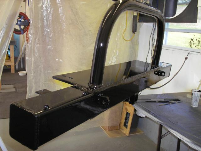

Well, Thermos and I shot the bumper today and I must say that I am thrilled with the quality of the Nason products!
The system worked as planned and now all I need to do is wait for it to dry and install it!
I have no doubts that I can paint this plane myself! I will work my way up starting with the interior cockpit components and then get the gumption to do the smaller (empennage, flaps, ailerons and cowling) parts. The wings and fuse I will get assistance with, I think.
Now I just have wait for the test of time to take the toll and see how it performs! That is the real test. Any idiot can shoot a paint gun!
CJ

BTW, another thing to add...
I have found this Primer Sealer from Nason and I plan on using it for the next set of fuselage components.
Then there is this Epoxy Primer. I suppose it is like the PPG stuff Thermos and many others are using.
The thing about epoxies is, you don't want to leave them exposed to UV's. I am told that they tend to "chalk up" in sunlight.
CJ
