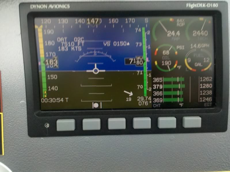

I am able to fly faster than before due to the increased stable feeling. I was level at 186kts, but hard to snap at pic that is readable with my phone. (ignore the fuel flow, it failed last flight, now shows 5gph at idle).

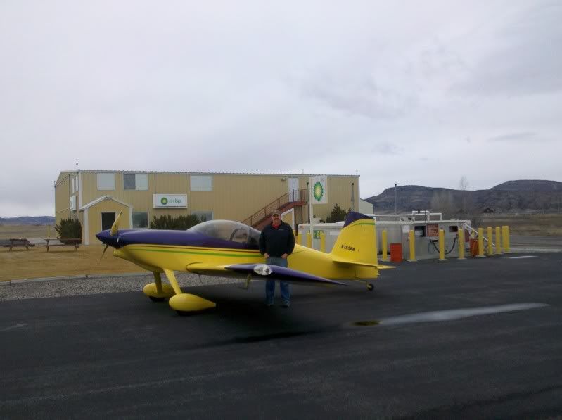

Went to 9S5, to visit the FBO that is helping me host the SARL race.
Life is good. 16hrs to go and then it will be even better.

Glad to hear the problem is fixed. Looks like you have a nice fast plane.
Can't wait till my plane is done.
Rob
RV7A (finish kit)
RV4 N97RT (sold)
Dude...you've got to have one of the fastest 7's out there! That is just SMOKIN'!!! 8)
cjensen wrote:Dude...you've got to have one of the fastest 7's out there! That is just SMOKIN'!!! 8)
it's that paint scheme you worked up for me, even looks to be going fast when sitting still. :mrgreen:
I pretty sure I'll be over 190kts when I get things dialed in. I never had it WOT, > 2500rpm and level at the same time. I was climbing out yesterday at 2600fpm at first then settled into 1800fpm from 4400-7500msl. The RamAir seems to be working real good at altitude also.

Brian, what kind of G's are you seeing when you are getting beat around? Hard to believe it can be anywhere near the planes limits.
Or are you talking about breaking yourself :)

I don't know about the G load. I've only had a few hard hits, but it seems the turbulence is constantly popping the plane around. Since I'm up in the yellow arc, I don't want to take a big hit....I'm probably just a big wuss.

You can check the g loads on the 180, and reset them whenever you want. I have them on the display where you have the VS indicating 150. Those EFIS units have lots of info, if we can find it :bang:
