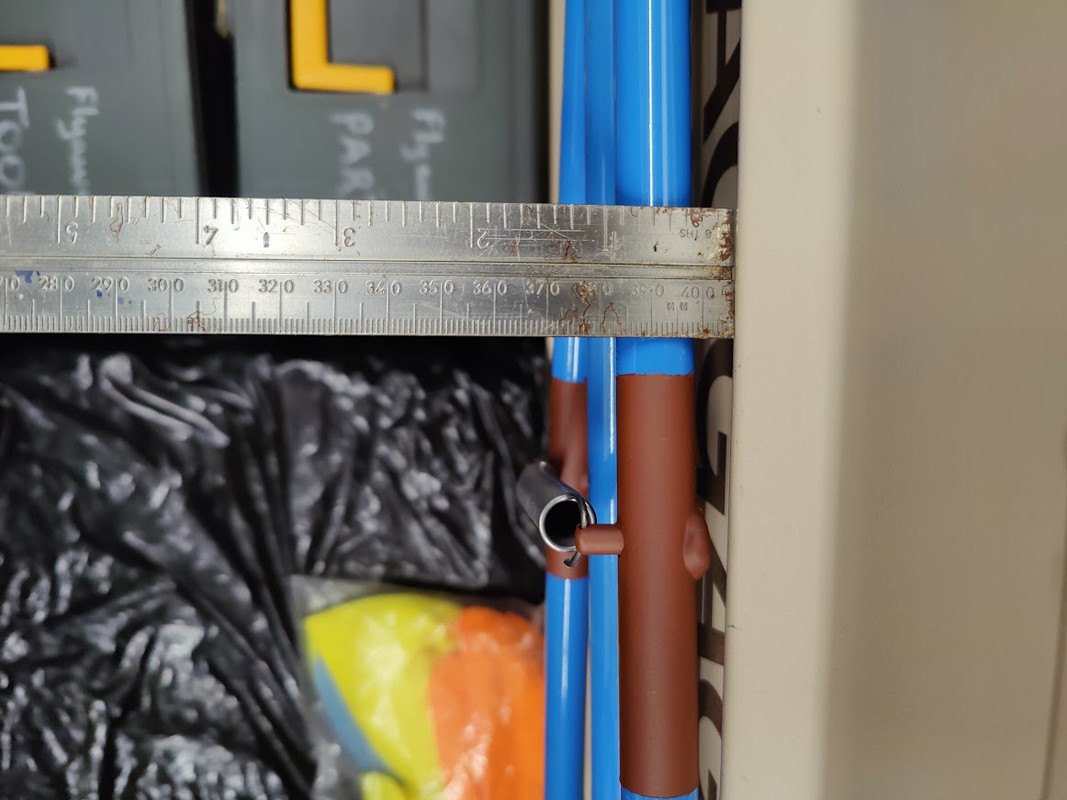

I decided to reduce the profile of my tow bar spring retaining rods by 0.5 inch. drilled new holes and cut. now the profile of the entire tow bar does not exceed 1.5 inch from the aft baggage bulkhead. hey, I load a lot of gear in this space, and I need every 0.5 inch I can get. now it's snug as a bug.

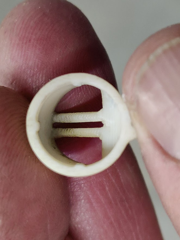

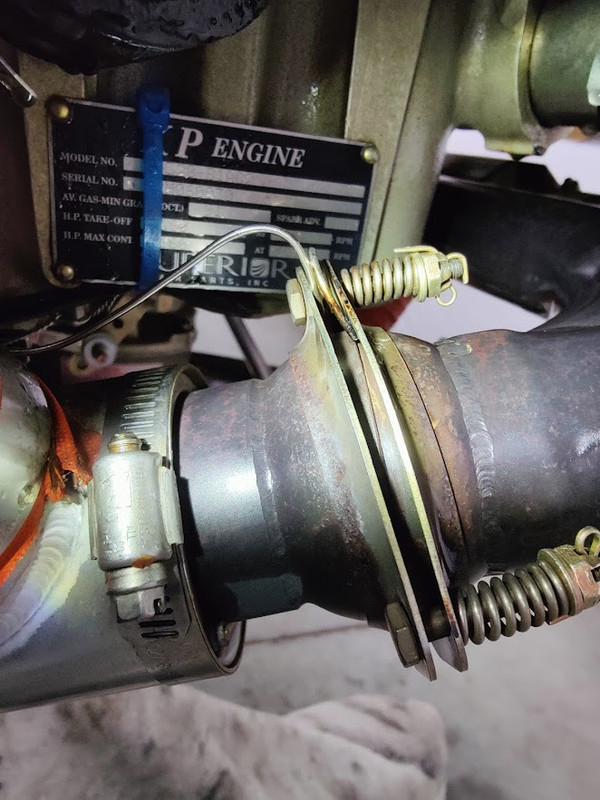

I decided to remove the cowl to determine how much -6 and -8 hose to order for hose replacement. while I was in there, I checked my remote exhaust ball joint oiler tube (looks good) and sprayed the rubber parts with AT-205, a plasticizer. all rubber parts are 10 years and looking good, all original. I saw a YouTube video by Vic Syracuse, Base Leg Aviation, about drilling a hole in the fuel vent aft side and I thought it was a reasonable modification, a Vic Trick. I used .060 diameter which is plenty. I always watch Vic because I like his style. I use fuel vent bug blades in the Summer but remove them for Winter in case of icing. I have an upcoming trip across the plains in February and I know the weather can be bad. I re-oiled the air filter through the snout with a syringe and cleaned the housing with a paper towel on a stick.

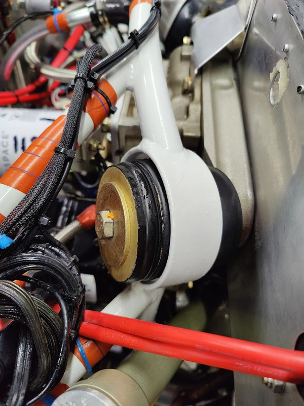

What are the wires running along the mount bars? Reif heater?
Posts: 1876
Re: what did you do this week - 2024FW4
yes, REIFF sump heater, two pads, total 200 Watts. the REIFF heater electrical cord appears to be house cord but sprayed with AT205 once a year keep it flexible. I just wound the cord in a loop. a thermostat on the REIFF heater will control the temp to 150F. a very reliable system, so far, 10 years.
