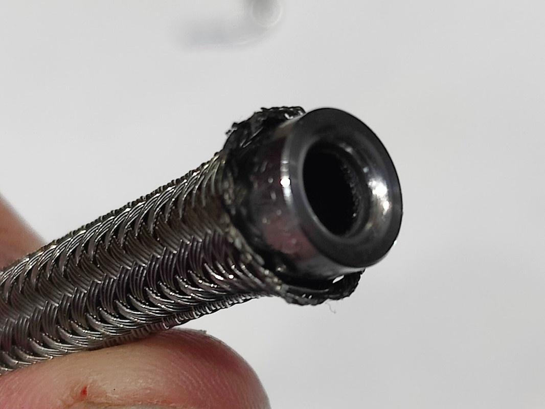

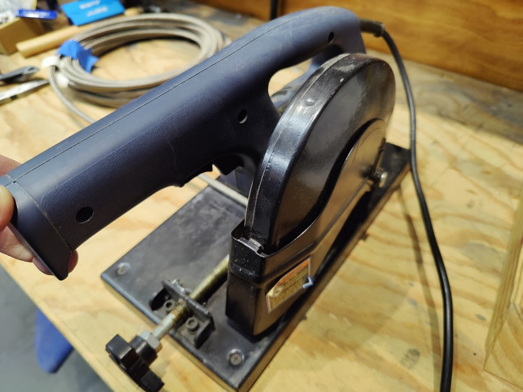

beginning to test some methods for cutting and assembling a PTFE hose. all certified components by Aeroquip, except for the fire sleeve banding.

OK, I made the first hose in my life. all certified components. hopefully, it doesn't fall apart. I made it slightly shorter than the original VA-133 hose for optimum fit for my aircraft. the instructions were very easy to follow. they were right, after the hose is cut at both ends, you will notice that one end braid opens and the opposite end closes. makes it easy to slide the sockets on the hose. install sockets skirt-to-skirt.

installation toque Aeroquip Super Gem Steel Fittings (STEEL on STEEL)
note: this is hose installation torque, NOT hose build torque, no torque values are used for hose build but rather a 1/32-inch clearance value.
