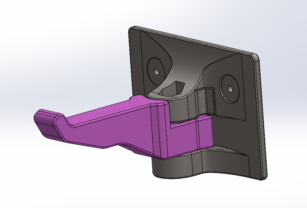

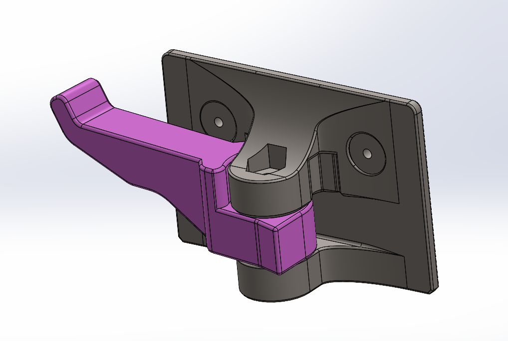

headset bracket - forward arm swing 90 degrees with an aft stop for the right-hand-side.

Posts: 1973
Re: a couple printed widgets
headset bracket with forward arm swing and 90 degree stop.... first print with 90 degree stop, perfect. it is a robust part.
2.5 inch arm allows for approximately 3 inches of land.
