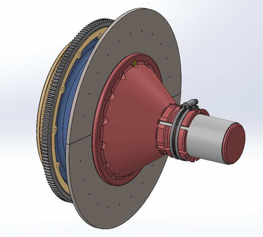

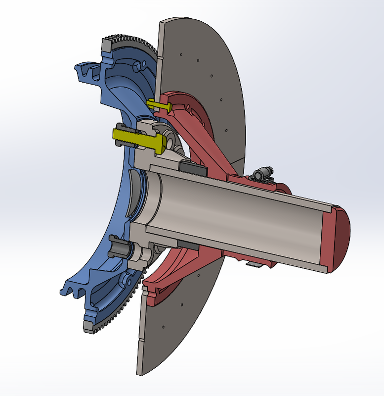

Killing time, imagining the perfect cowl support tool I’d like to have. There are plenty of versions out there, but I want one stiff enough to really lean on, made mostly of plastic with a sturdy aluminum plate. We’ll see how it turns out.
I spent a couple more hours on this today. So far it seems to be doable, and the tool has a reasonable range. I still need to work the details.
working the details.... not sure how best to mark the alum plate for reference. thinking about some scribed lines or plates with dedicated outer diameters. added a keyed spacer as an option to be able to easily remove and reassemble the tool to the same position.
The engine parts in these photos are from the 390.
