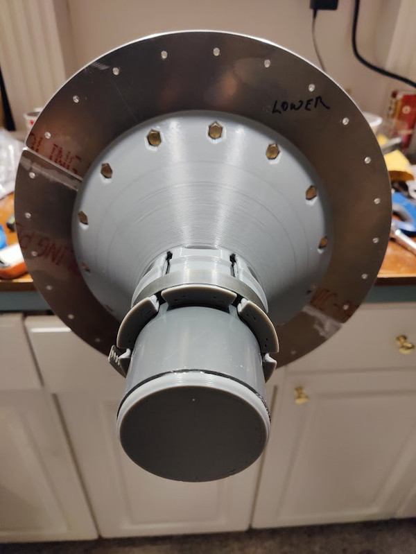

Killing time, imagining the perfect cowl support tool I’d like to have. There are plenty of versions out there, but I want one stiff enough to really lean on, made mostly of plastic with a sturdy aluminum plate. We’ll see how it turns out.
Posts: 2099
Re: A couple printed widgets
I spent a couple more hours on this today. So far it seems to be doable, and the tool has a reasonable range. I still need to work the details.

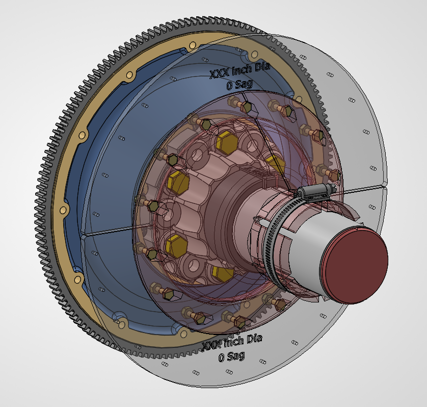

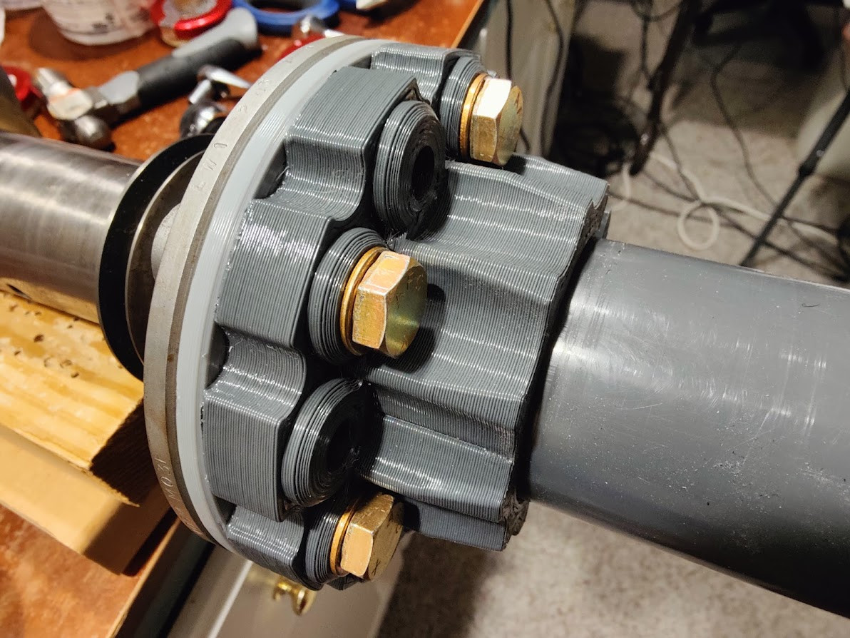

working the details.... not sure how best to mark the alum plate for reference. thinking about some scribed lines or plates with dedicated outer diameters. added a keyed spacer as an option to be able to easily remove and reassemble the tool to the same position.
The engine parts in these photos are from the 390.
Posts: 2099

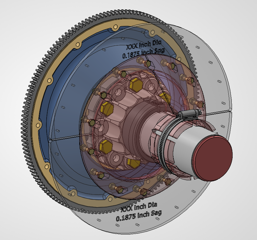

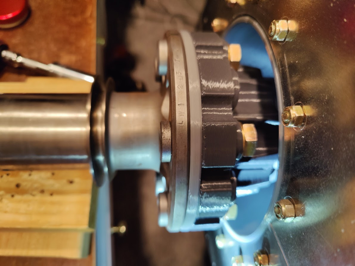

I’m still fine-tuning the details of this design. I adjusted the spacing, so the gray spacer sets the spinner aft edge offset from the ring gear support forward flange precisely. This makes it easy to determine the exact forward spinner offset and verify it using the spacer’s marking. In the photo, the cowl outer plate is configured for a 360 cowl with a 390 engine. It will probably turn out that only a couple of different spacers are needed to cover most of the available products and if a custom spinner spacing is needed it is a quick print for a new spacer length.
The outer aluminum plate can be tailored to compensate for engine rubber bushing sag, .125 or .25 inch, whatever is needed.

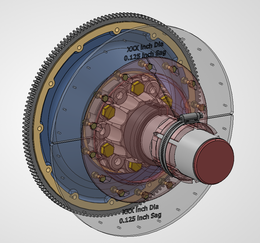

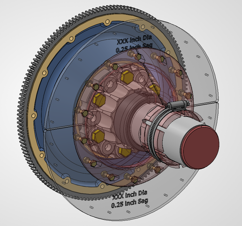

In this example, the outer aluminum plate circle has been shifted downward by 0.25 inch to account for engine sag. This adjustment will position the cowl center 0.25 inch lower than the current engine center. It can be helpful for those with new rubber engine mount bushings that will settle into their final position over time. If the engine has been mounted for a year, this much offset might not be necessary.
so you don't end with this sagging look....

The design is complete, and manufacturing development along with the first article inspection is now in progress.
Note: If the starter ring gear support (flywheel) isn’t installed, use the optional 0.25-inch spacer at the propeller flange to ensure proper fit. The tool base won’t mount directly to the propeller flange without this 0.25-inch spacer.
The tool is somewhat Murphy Proofed as all that is needed to ensure the cowl fwd face axial position from the flywheel is to read the number on the internal spacer and that is what you will get.

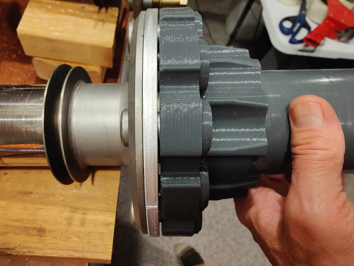

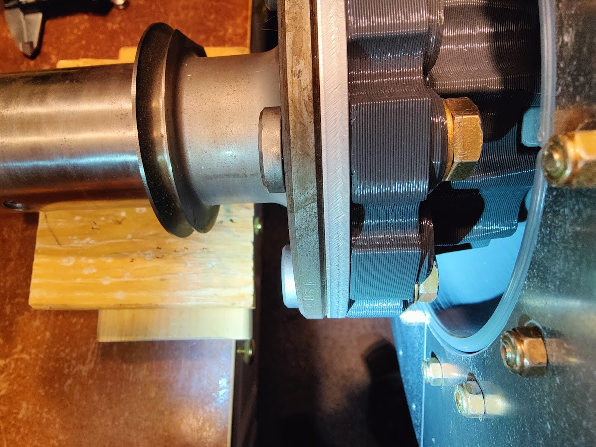

Posts: 2099

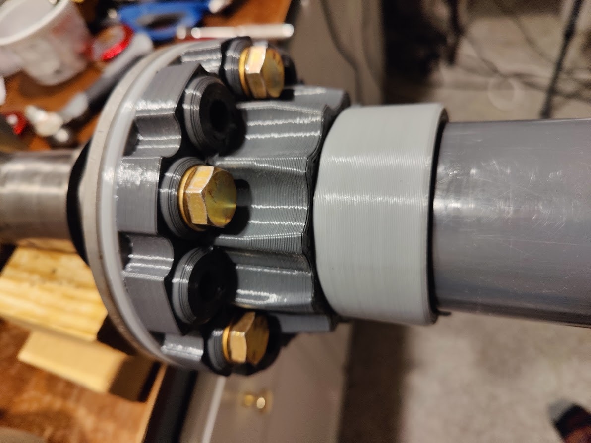

I’m working on the first print of this part, and it’s always exciting to start on a 1.5 lb piece. All the parts have fit together well so far. I still need to print the base and bond it to the pipe. The locating surfaces are printed in fine height detail for accuracy. This is a rigid tool than you could really lean on, .25-inch alum plate. From a geometry perspective, cones are stiff in both the axial and radial directions, compared to a flat plate and cylinder. Read the number on the spacer and that is the offset from flywheel (ring gear support flange). If the flywheel is not installed, use the flywheel spacer.
Posts: 2099

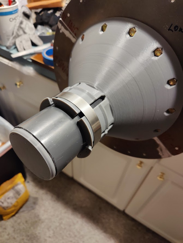

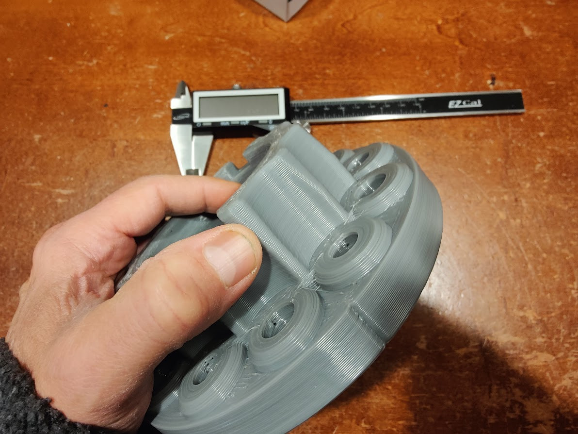

Making steady progress on this one, and everything seems to be going smoothly. The first part off the printer looks great, and I’m getting ready to start printing the base. It is very robust and accurate.

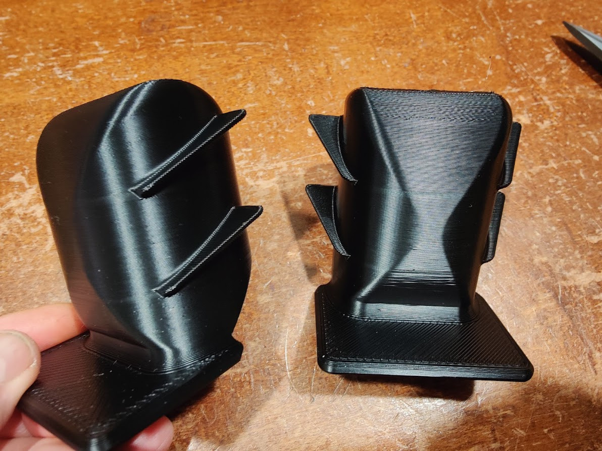

I printed some RV8 cowl inlet air dams today, completely hollow to be lightweight enough to avoid blade passing frequencies. Printing them this way seems to defy the laws of printing, but it works. I’m also back to working on the last part of the cowl support tool, though I’m running into a few issues. It needs some fine-tuning and should be finished by tomorrow.

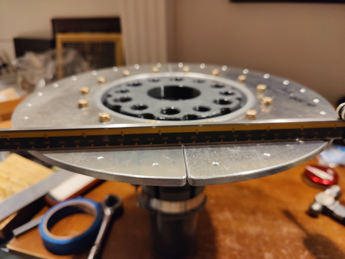

Posts: 2099

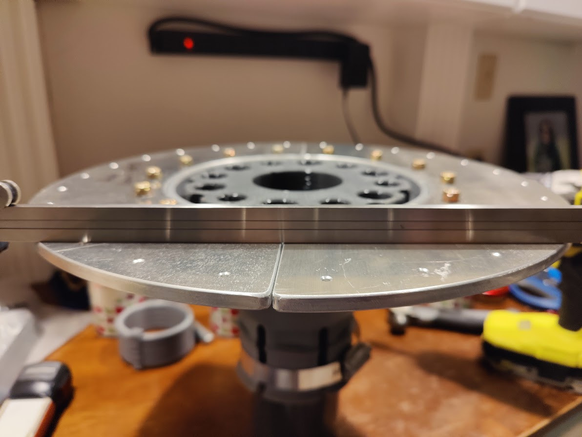

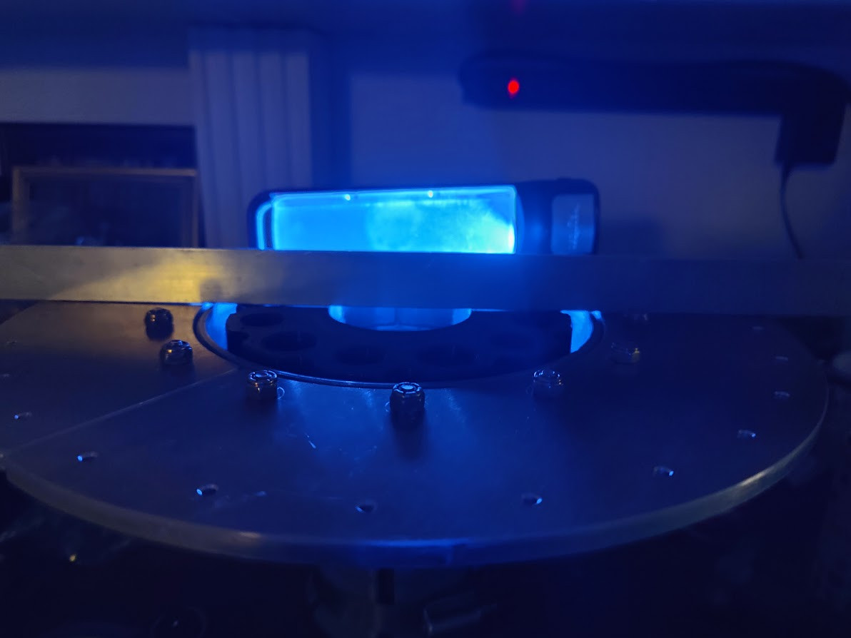

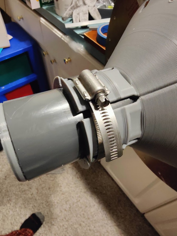

Cowl Support Tool... making some progress here. The plate’s flatness from the Zero-Zero contact surfaces measures within 0.010 inch, which isn’t bad for a first print. The plate is very rigid—I could probably stand on the end of the center pipe. This is definitely a tool you can lean on. The hose clamp should be one size smaller so it doesn’t stick out, since people will be working around it. Not too bad for a first part.

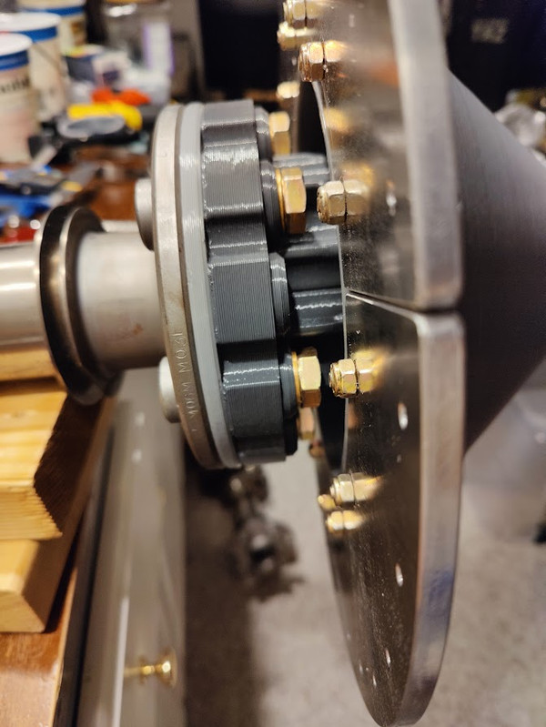

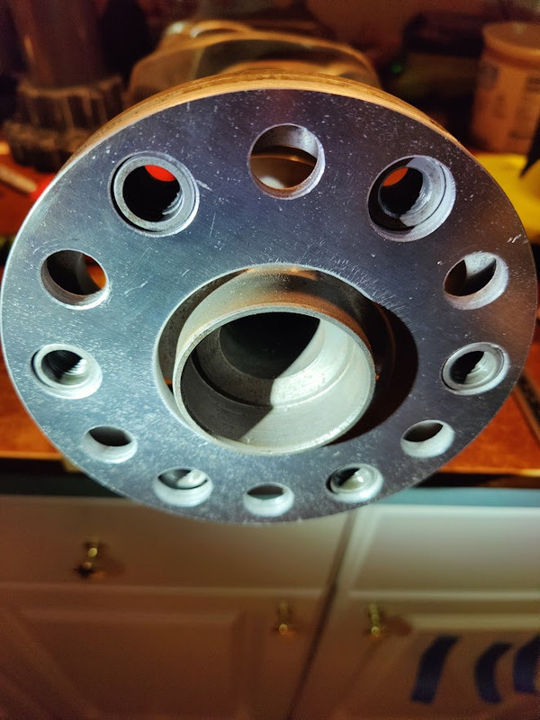

Posts: 2099

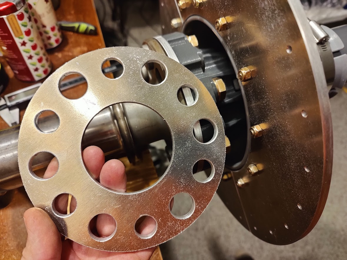

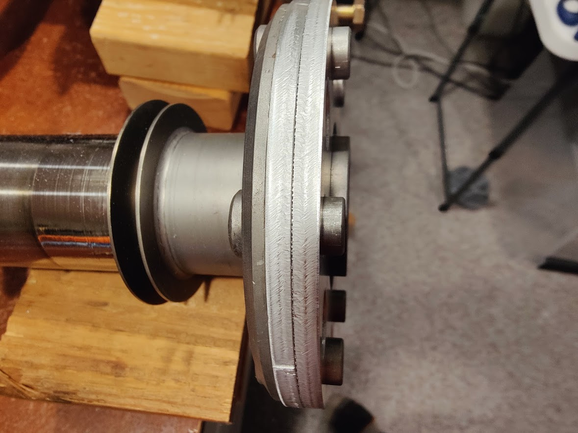

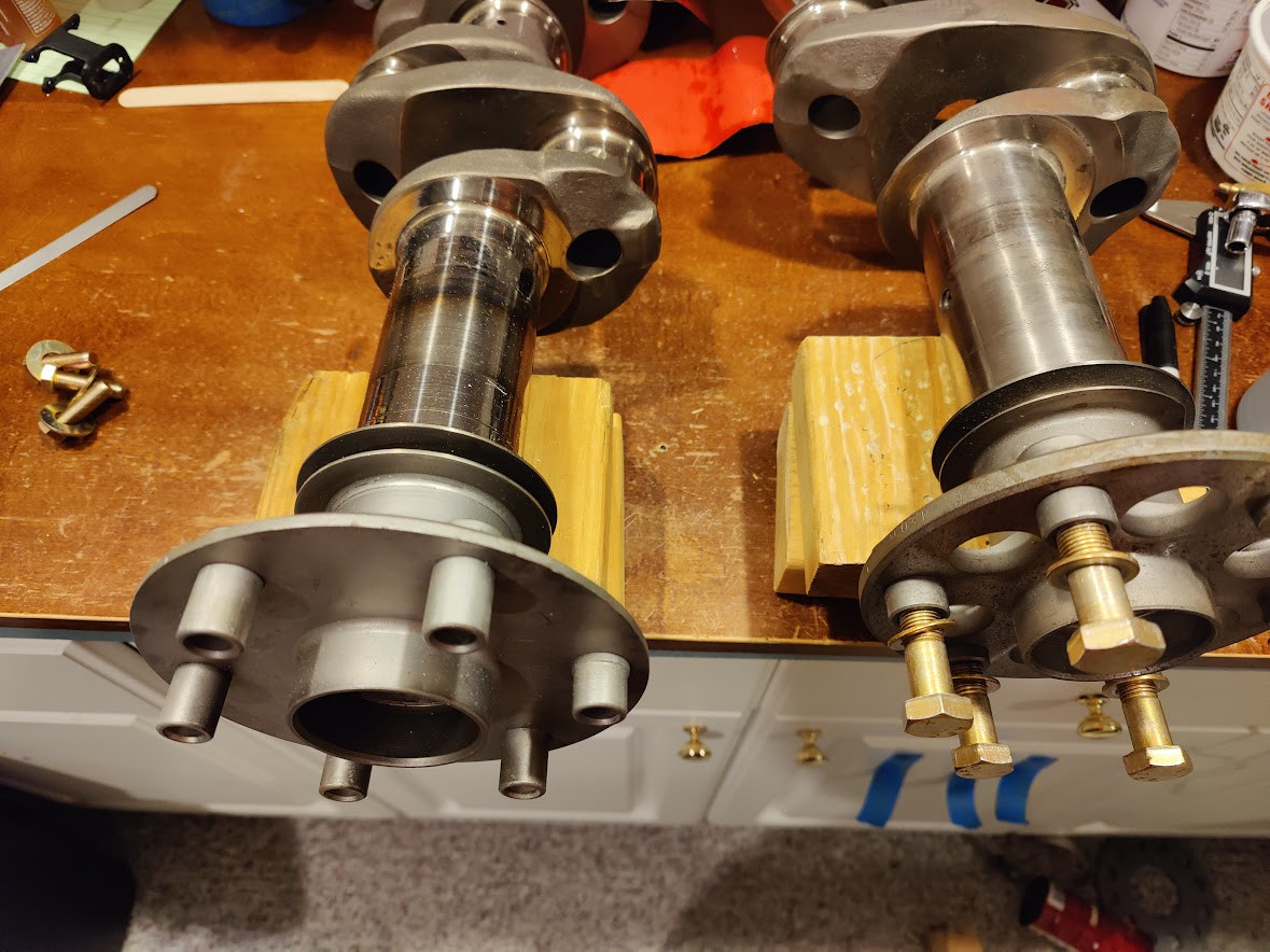

Some crankshaft lugs are longer and use 3/8-inch bolts (I believe these are older versions). For these, if the flywheel isn’t installed, add an extra spacer plate so the tool can fully engage; if it is installed, just use one spacer plate. For crankshafts with 7/16- or 1/2-inch bolts, use one spacer plate if the flywheel isn’t installed, and none if it is. The spacer plate matches the flywheel’s thickness. So far, the tool is working well, and the spacer plate fits nicely with about 0.003 inch of wobble clearance.
