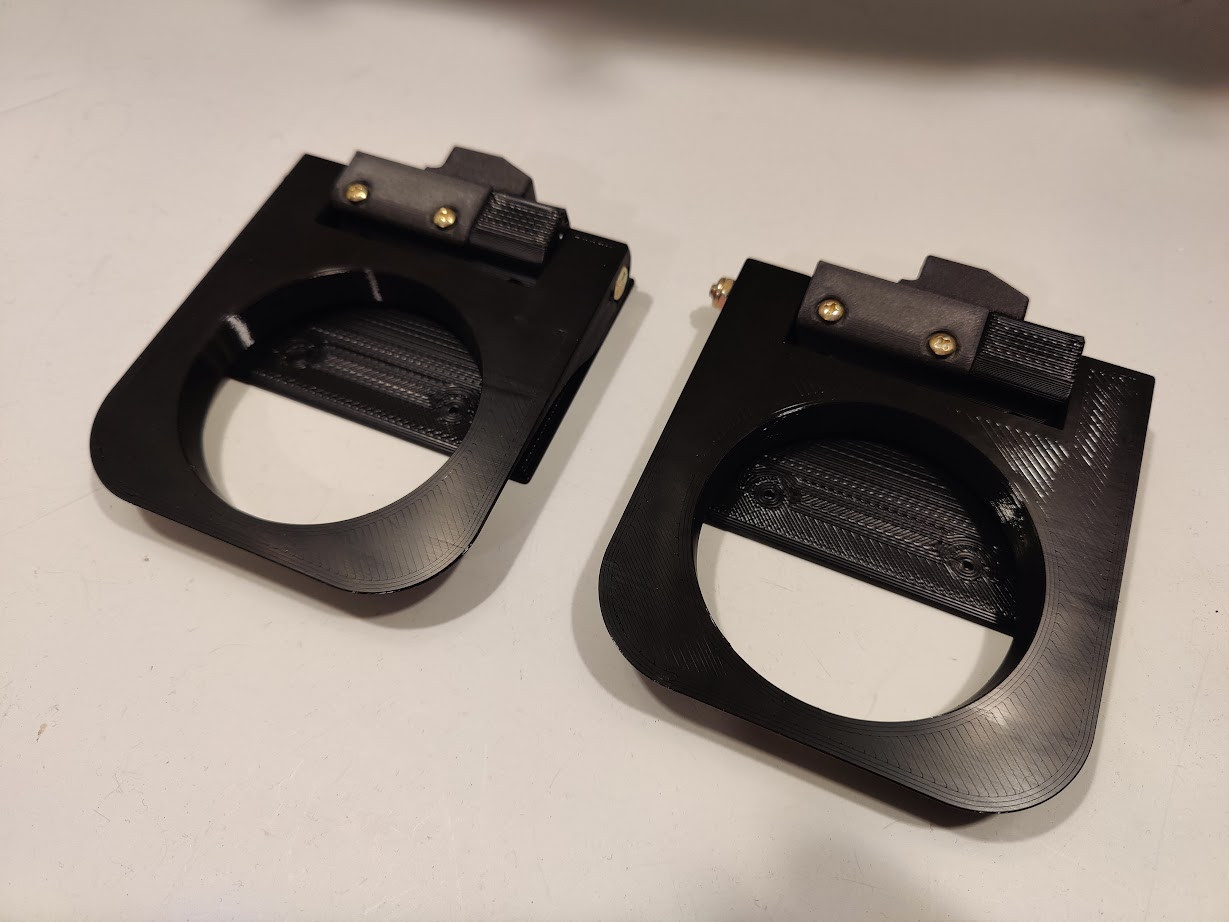

I made some more of the most expensive cup holders in the world, but they will most likely last the life of the aircraft because they are very robust.
