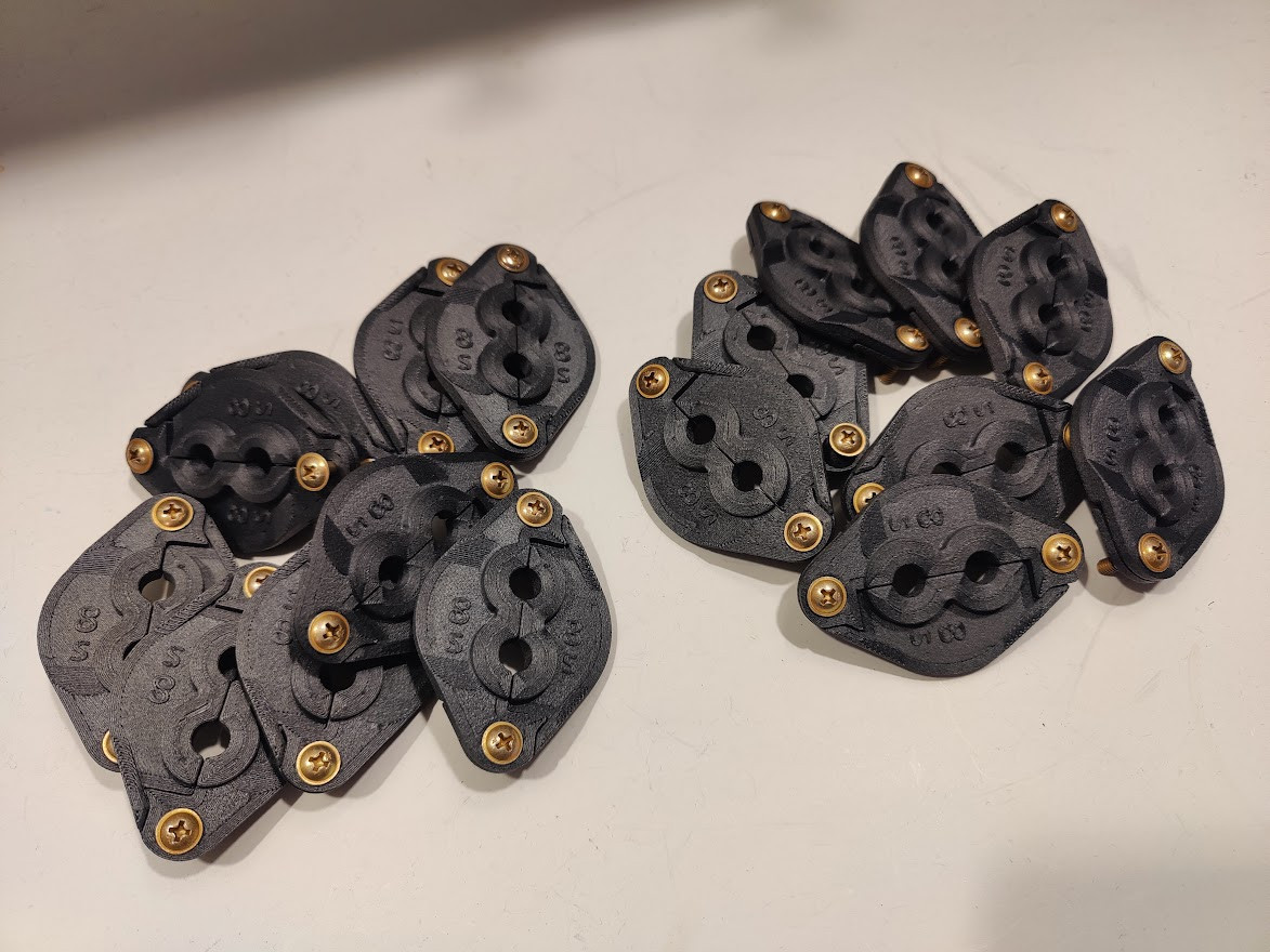

more baffle wire seals printed yesterday.... these are 8mm S (for Sulfide), three holes. very popular. turn up the heat!

I had run short of the polyphenylene sulfide 8mm, 2-hole baffle ignition wire seals, so I printed some more today. You can turn up the heat on these as they are capable, 350F. The "S" marking on these is for sulfide.
