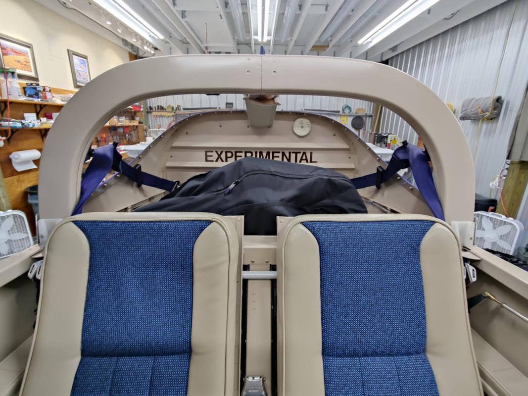

thinking about a secondary seat belt restrainer for loading the bike. need the exact contour from the skin.
I don't know how well this will work, a prototype.

seatbelt restrainer.... good fit. I'll try it for a while. good for holding the belt out of the way for loading. installed between screws 6-7.

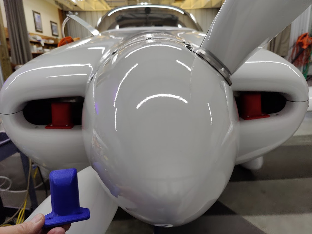

cowl inlet air dams for Winter. the low is going to be -10C here in a couple days so I installed my air dams. my engine seems to do better if I keep the temperature up in the Wintertime. I was consistently having lower compression on a couple cylinders after Winter, but after using the air dams they returned to normal. that's all the evidence I have. going on my 3rd year for these (maybe 4th, I can't remember since I lost my stream on Van's Airforce). 5-minute install and the cowl hasn't suffered any damage from the air dams. 1.5-inch or 2.0-inch wide air dams work well for me (blue or red). 2.5-inch (black) for extreme cold, -30C, but some would say -30C is warm. CHTs remain balanced when the air dam is mounted in the middle of the inlet. these are printed hollow, like a balloon, to keep the air dam natural frequency response high so the blade passing frequency does not interact.

getting ready for a bike ride on Thursday but the low is predicted to be -6C and 3C for the high, so colder. I swapped my 1.5-inch cowl air dams for 2.0-inch. the clock turned 7:04 when I began and just turned 7:08 when I finished, so 4 minutes to swap at a relaxed pace and a torque check. CHT's remained balanced when the inlet blockage is in the middle of the opening. the Zizzo Liberte folding bike is working well.

seat belt side restrainer. needs to be longer and is now narrower. I'll test it for a while.

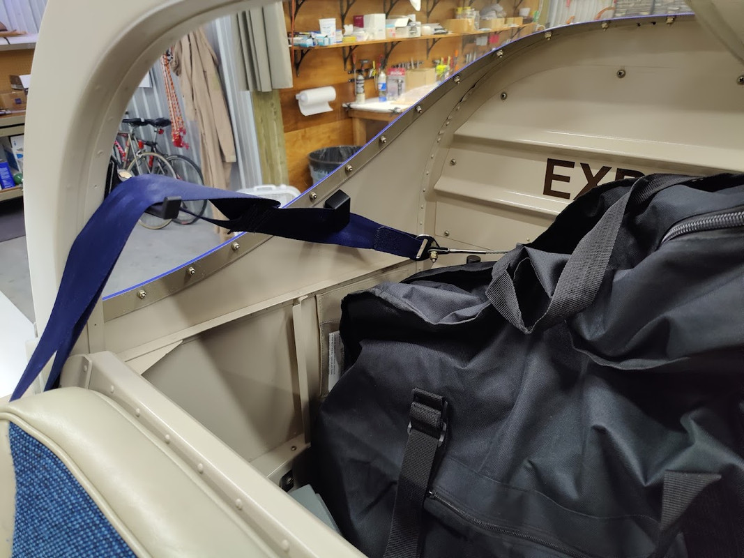

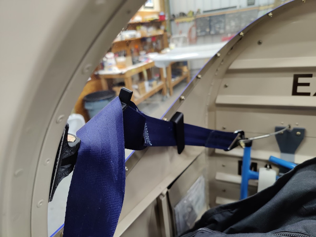

seat belt side restrainer V2. better than V1. I'll test it for a while. these only work with the seat belt hooks. opens the spacing for loading bikes. these restrainers match the skin contour between the 6-7 aft canopy screws, counted from the forward side.
once, when loading a bike, the seat beat became caught, and the weight of the bike pulled a seat belt hook (the one attached to the roll bar) off its dual lock Velcro mount. so, I snapped it back on and all is good. I think 3M Dual Lock Velcro is the way to go for these hooks. the Dual Lock on mine are original and a couple years old and no signs of any adverse condition and always subjected to the hanging loads of the belts when not in use.

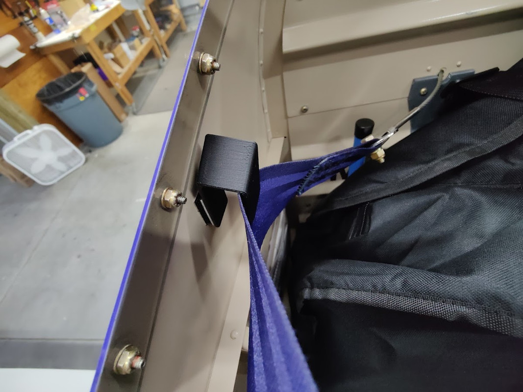

another seat belt restrainer for the baggage area. a simple part that may be useful to restrain the belt to the side if you do not have roll bar mounted seat belt hooks. a prototype....
a couple options for placement but it does not get the belt up as high and out of the way as when using the roll bar mounted hooks.

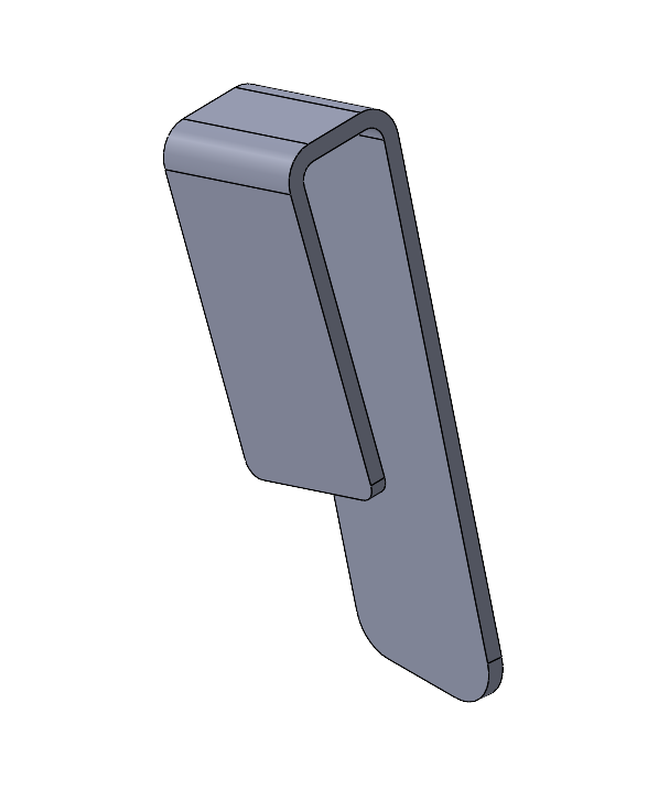

a conduit hanger could be a handy part. a simple part to design and make. follow along.
since we don't know the final location of the part yet, I'll add a circle and extrude it to make the conduit. the conduit location will be adjusted later.
OK, that was 10 minutes of work, need to take a coffee break.
offset the outer conduit circle .03 for clearance. then offset that circle .10 inch to make the outer ring of the hanger. draw half of the rivet mounting surface and then mirror it and extrude it .10 inch. all of these dimensions will be fine-tuned later, we are working to get the basic shape now.
OK, that was another 10 minutes, time to take a break and listen to some music.
add some holes, fillets and a chamfer. snug the conduit closer to the edge of the lightening hole. decrease the clearance to the conduit to be .04 inch diametrical. show the arrangement with two conduit tubes at 45 degrees (baseline), 30 degrees and 60 degrees.
OK, that was another 15 minutes. time to print one for a test fit and determine if I can take some weight out.
so, about 1 hr working time to do one of these from scratch at a very relaxed pace. it's just play for me now.

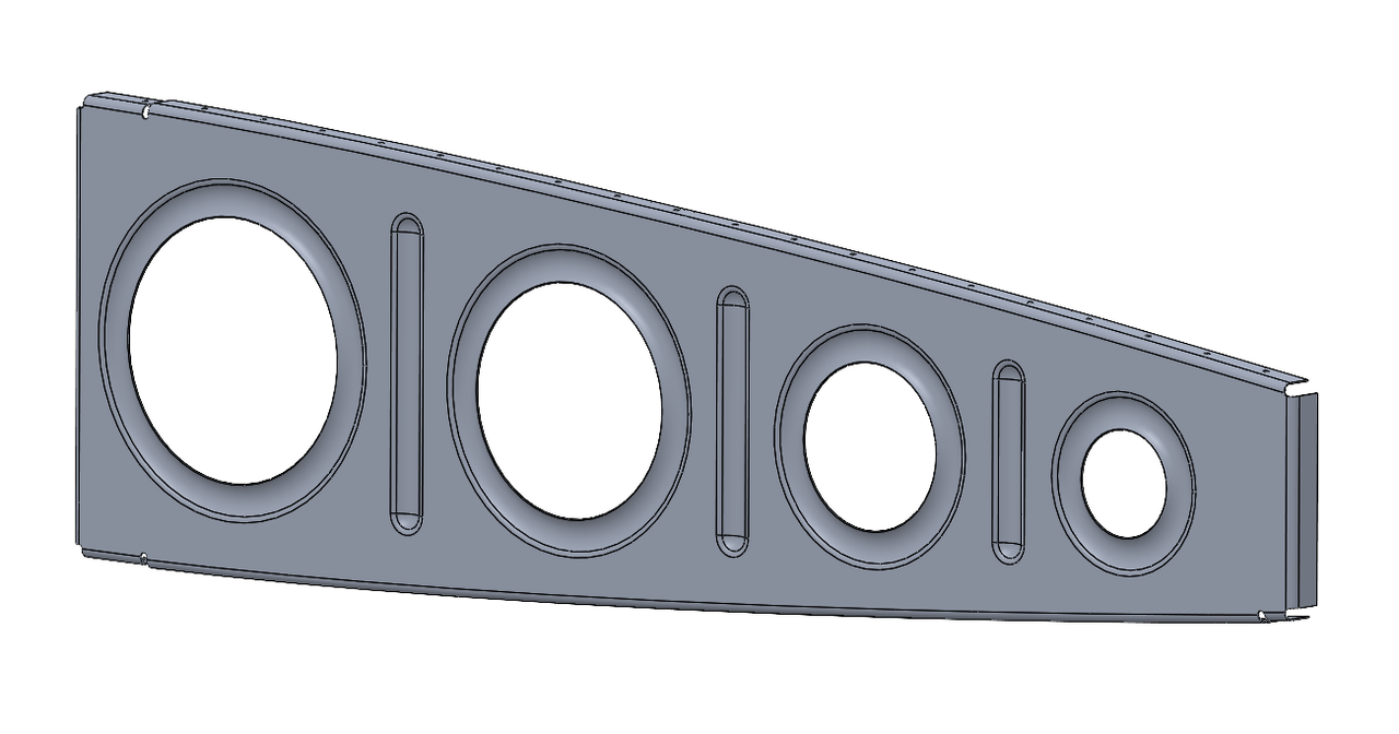

assume conduit hanger supports 1 lb of wire, then multiply by a g-load of 6, then multiply by 1.5 = 9 lb. the most outboard area is not doing much work and just going for the ride. opportunity to reduce weight, but we already knew that the material between bolt holes generally doesn't do much work, right? the next time you see a scalloped flange, you will know why.
taking a closer look at the rivet holes to simulate compression only at rivet hole wall that is closer to the real condition. for an ultimate 9 lb loading for this part, there is some localized exceedance at the hole edge, but the bulk of the hole is within the allowable limits. the plastic material has adequate strain capability to absorb and distribute this localized stress.

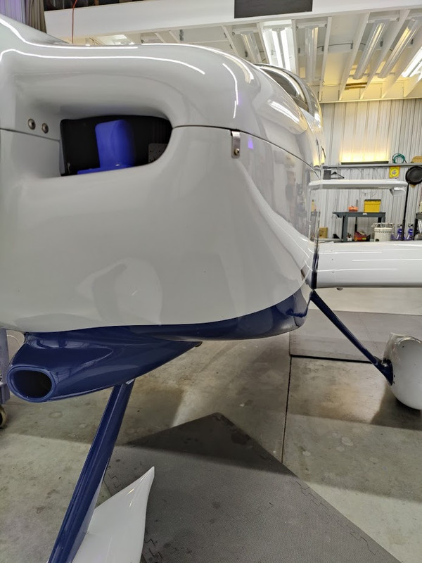

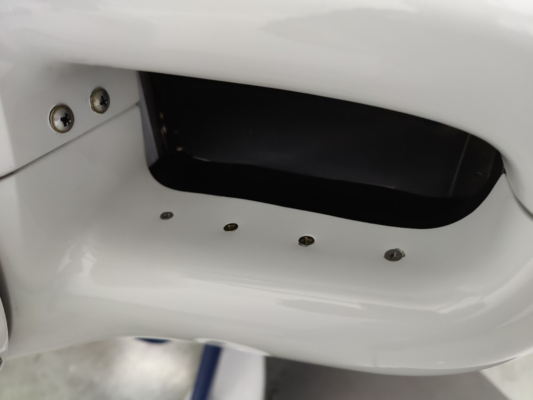

Cowl inlet air dams. I switched from 1.5 inch to 2-inch width air dams about a month ago and I have been noticing a faint whistle since then when I am letting down to an airport at max speed. I am wondering if the 2-inch air dams are causing it, so I thought I would try test it by adding some vortex generator the sides of the 2-inch air dams. I am not sure how well I can print these but probably good enough for a test.

2-inch air dams currently installed.
with vortex generators and yes, I realize the vortex will be fighting each other.

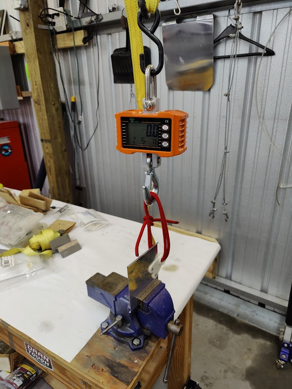

pull testing the conduit holder. a pull test to failure doesn't mean the part can take the pull test loading 10,000 times. the stress analysis concludes that it can withstand a 1 lb wire weight load (1 g-load), 6 lb cycling limit (6g-loading) load and 9 lb ultimate. this test is simply a sanity check. this part made it to 77 lbs with no visual adverse effects. it could have gone higher, but the test setup was marginal and risky for the operator. the part was attached to .025 2024-T3 sheet using LP4-3 rivets. part weight = 5 grams.
