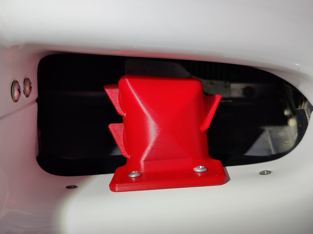

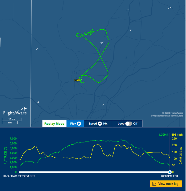

2-inch-wide air dams with vortex generators. I took my BFR Saturday. on the way home, descending into the airport I heard the whistle sound. I asked my check ride pilot if he could hear it, but he could not. he has some hearing aids and says his hearing is not good, but I could hear it. neat flow plastic flow lines into the generator fins. not much added fin weight to these. first two of these to print, not perfect, but good enough for testing.
Marsh - Lailonie (Official Music Video)
https://youtu.be/9XFkGCQzV8U
to replace these...

Re: a couple printed widgets

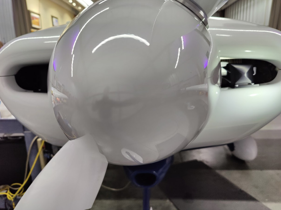

2-inch-wide winter cowl inlet air dams with turbulators installed. I am hoping the turbulators cure a faint whistle I hear when I am 140+ kts. I hope that's all they do and that they do not cause any other problems because the air dams without turbulators are great except for the whistle. I think the 2-inch air dams are causing the whistle because I didn't hear it with the 1.5-inch-wide air dams. these air dams are hollow like a balloon.
https://youtu.be/pX910vSInzA
yep, these air dams eliminate the whistle. I think the turbulators are adding some additional blockage because my CHTs were up 5F over the non-turb version. 0C OAT at 6500 ft, 65% power, CHT 1-3 were 320 +/- 2F, but CHT 4 was 340F. CHT 4 had been creeping up over the past year to run +15F hotter than the others. I probably need to do some baffle work around #4. max speed during this testing was 166 KIAS, 178 KTAS. I will keep these air dams for the remainder of the winter.
in order to get some additional air to #4 cylinder, I angled the top and removed one turbulator from the short side. I am not sure this will work.
leveled the upper gap to cowl on the right-side air dam. I noticed #2 CHT dropped 5F. #4 CHT came closer in-line with the others. 2" wide are probably good until late January, then change to 2.5" wide for February. OAT = -5C today at 6.5K ft. good CHT cooling in extended hard climb, less than 360F, cruise ~315F.

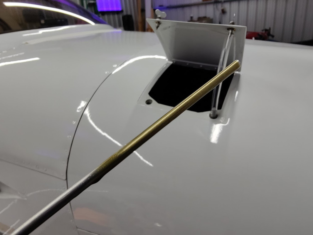

flap cover lift buttons are holding fine.
2.5 inch wide air dam with turbulator test fit, significant blockage, but not flight tested yet. the right-hand side is done but I misdrilled the left-hand side, so it is scrap. I ask the Gods; how can I do stupid stuff like this? today the OAT on the ground was 10C but 0C at 6.5K ft. using the red 2-inch-wide air dam my CHTs were 335-345F and oil temp was 190F (fully tape blocked). OK in the climb because the air can go over the top of the dam. 50 hrs on the oil, I'm having a hard time getting around to changing it. windy today, not many flying. large ground speed change, no altitude change (winds howling). if I lost a brake, my big rudder may have kept me on the runway. if I had a small rudder, no chance.
Darth Vader, left-hand side now installed. need a cold day for testing, -5C or so on the ground.
I didn't get -5C on the ground but rather +4C but flew anyway. CHT were 340-350 at 4K ft and the OAT = 0C. they were good in the climb and didn't see CHT over 360F. so, cooling is pretty good in the climb and blockage is good in cruise. I was happy with them.
when they are black color, they are almost invisible.

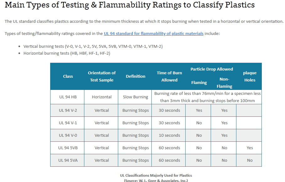

conduit support.... working to find the proper clearance for the conduit supports. I have a nice snug fit on these. the measured conduit OD is pretty close to the listed but not exactly. these conduits are from Heyco (same suppler for the snap bushings) and are flame retardant UL94-0. they are certified to extinguish any burning within 10 seconds. I'll test for that.
I had some Van's conduit but threw it away because I was busy building a loft and really cramped for space. I'm not sure of the Van's conduit rating. I believe the Heyco conduit is stiffer than the Van's, if I remember correctly.
I don't know why there would be a need for anything larger than 21mm nominal diameter.
these are 13, 16, 21, and 28 nominal diameter.
my measurements
Heyco sizing and UL rating definition
UL-94 is the Standard for Tests for Flammability of Plastic Materials for Parts in Devices and Appliances. Within this standard, materials are subjected to various burning tests to see their performance in flammable conditions. Flammability UL 94 V method “evaluates both the burning and afterglow times after repeated flame application and dripping of the burning test specimen” in a vertical burning test.
To attain the UL 94V-0 standard, samples must have met the following criteria:
Burning combustion is not sustained for more than 10 seconds after applying controlled flame.
Total flaming combustion time for 5 samples does not exceed 50 seconds.
None of the samples burned up to the mounting clamp by either flaming or glowing combustion.
None of the samples dripped flaming particles that result in the ignition of the surgical cotton below them.
Samples did not exhibit glowing combustion for more than 30 seconds after removing the second controlled flame.

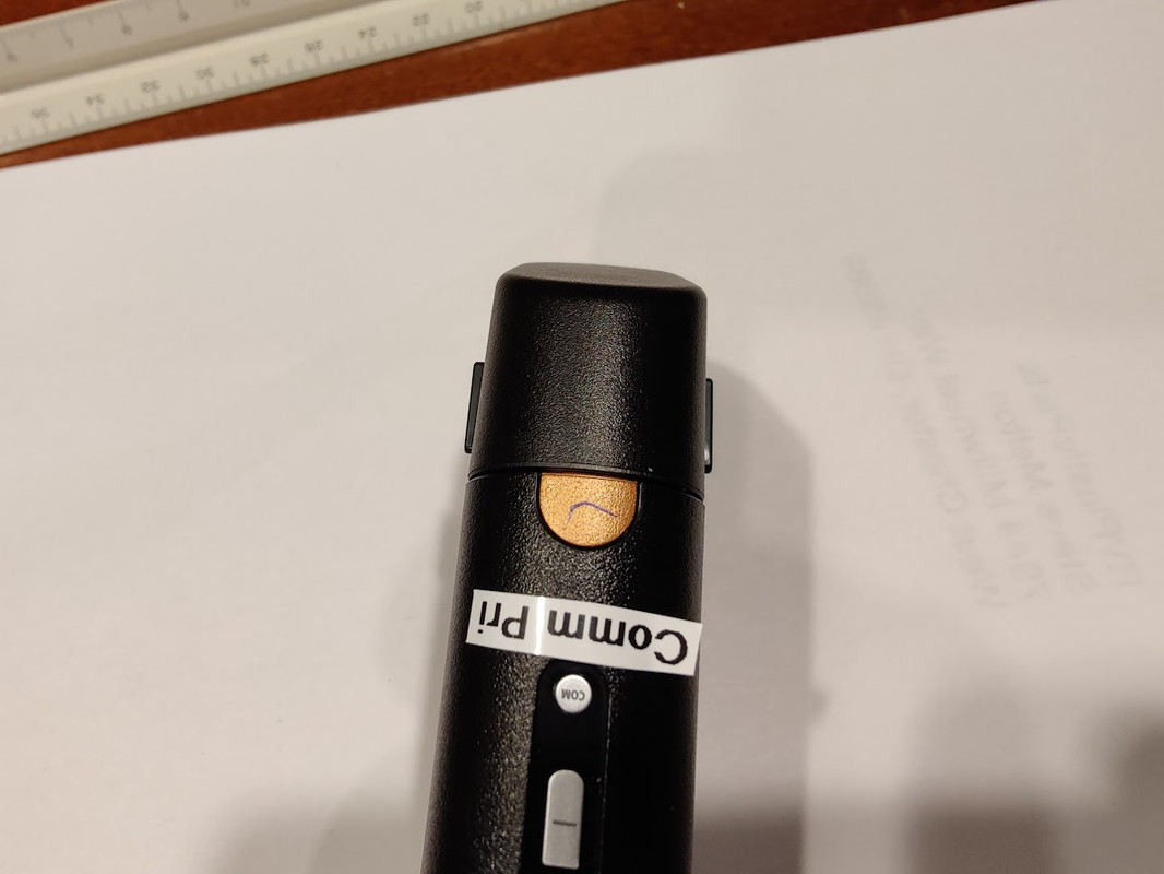

firstly, we need to make a representation of the delta zulu control module. for example, this is a model of the Zulu3 module. it is the only way to achieve a perfect fit.
Delta Zulu control module model. it is a long dongle. must be a computer motherboard in there.

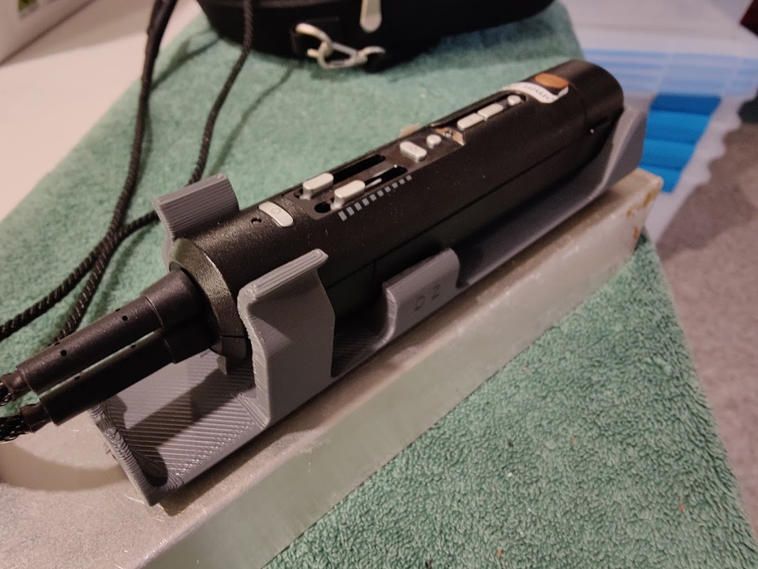

Lightspeed Delta Zulu headset control mount... test fit. it's a very good fit and perfect install motion. it is locked in all three planes. I may want to try one adjustment for curiosity's sake after I cycle it a few times. I don't think I have ever had one so good on the first attempt. I will definitely make my 7-day commit date and may beat it by 2 days.
