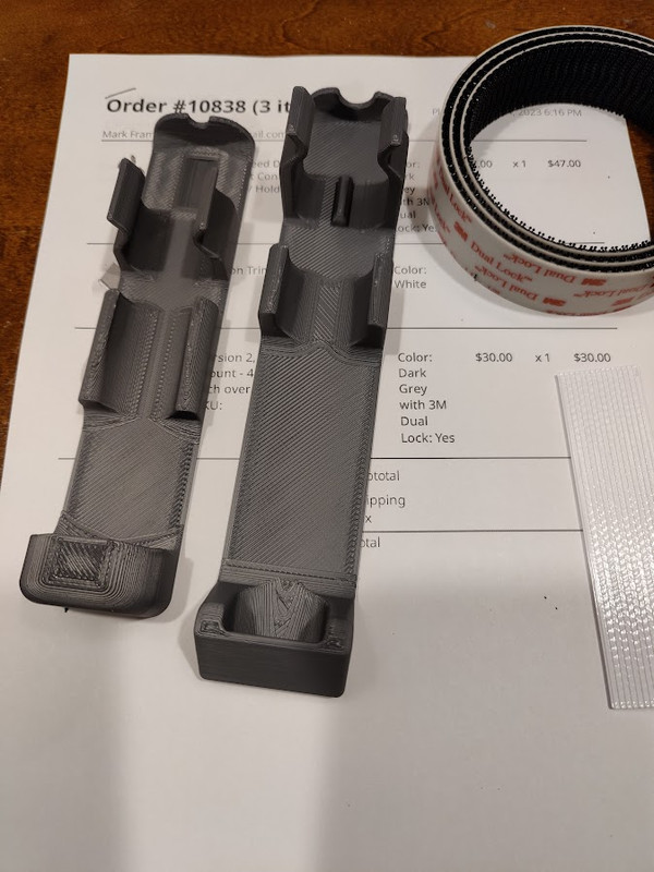

GPS Docks with variable mounting hole position. these are custom docks with adjustable outer dimensions, so why not the mounting holes. four positions at .125-inch increments to allow variable positions for the dock to extend out of the panel and ease installation. requires four screws total to mount, either the long side or the short side. get exactly what you want.
see the mounting hole position shift.... from the creator of the "printed GPS Dock", with a perfect operational record.

Garmin 660 GPS Dock with variable mounting holes to allow the dock to extend out of the panel if desired and ease installation. hey, why not?
also, the recessed GPS option..... a lot of options for the GPS Dock.

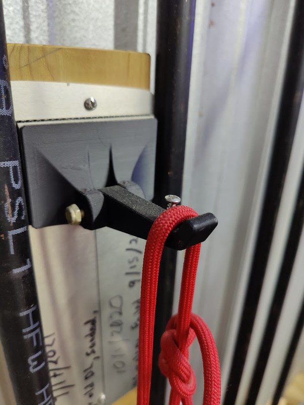

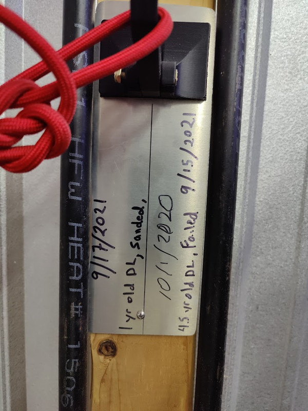

3M Dual Lock is really amazing. the screw dog stake weighs 1.1 lbs. it's been hanging there almost two years supported by Dual Lock. the first try was using old Dual Lock, 4.5 yrs or older that had been in my hangar, the plastic mount was as printed. the next round (current) used fresh Dual Lock and the plastic mount bonding surface was scuffed. I am amazed. Yoh, how long will it go?... I duh-no.

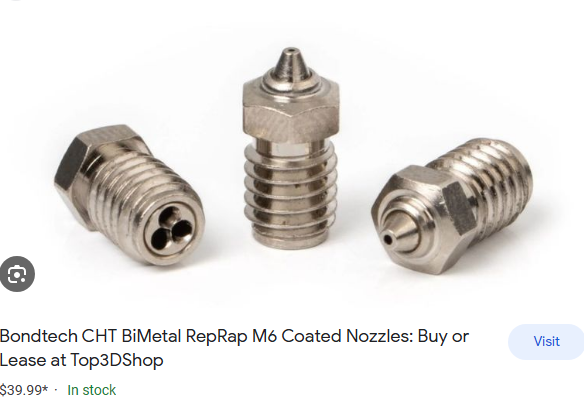

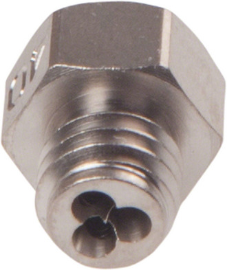

some are going to multi-core nozzles to improve heat transfer for really large nozzles, such as 1.4 mm. I'm not there yet.

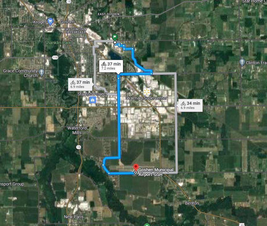

Goshen IN, MRRF 2023. a very nice trip. I think I found my next 3D printer. the people were great! I did my business within four hours. riding a bicycle from the airport on the roads there is very pleasant as people clear the lane for you, everyone.

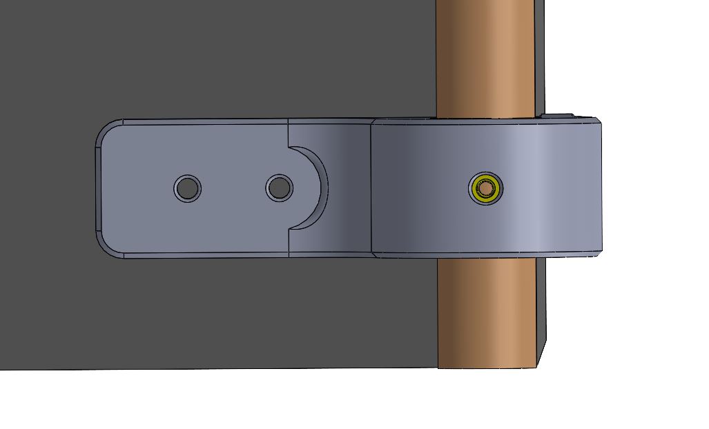

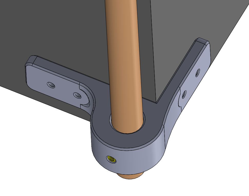

3D printing... fish tank lighting brackets. I have helped my youngest daughter, Amanda, build yet another fish tank. this time she is going for the "look" and wants a copper pipe to hold a 6 lb light. we did the analysis together (another teaching opportunity) and I cut all the wood with a circular saw. she put it together and even used pocket holes. I'm proud of her for being detail oriented, but it does get worse because now we have a DI water system for shrimps! anyway, these are custom brackets that align the pipe with back of the tank stand exactly, a design requirement. why, I don't know, she wanted it.
you can even listen to music together while you build and do silly dance moves.... she gets crazy at 1:11... :)
Kaskade, Brohug & Mr. Tape feat. Madge - Fun (Extended Mix)
https://youtu.be/AmJJUzGkFQ4
perfect fit. ABS....
