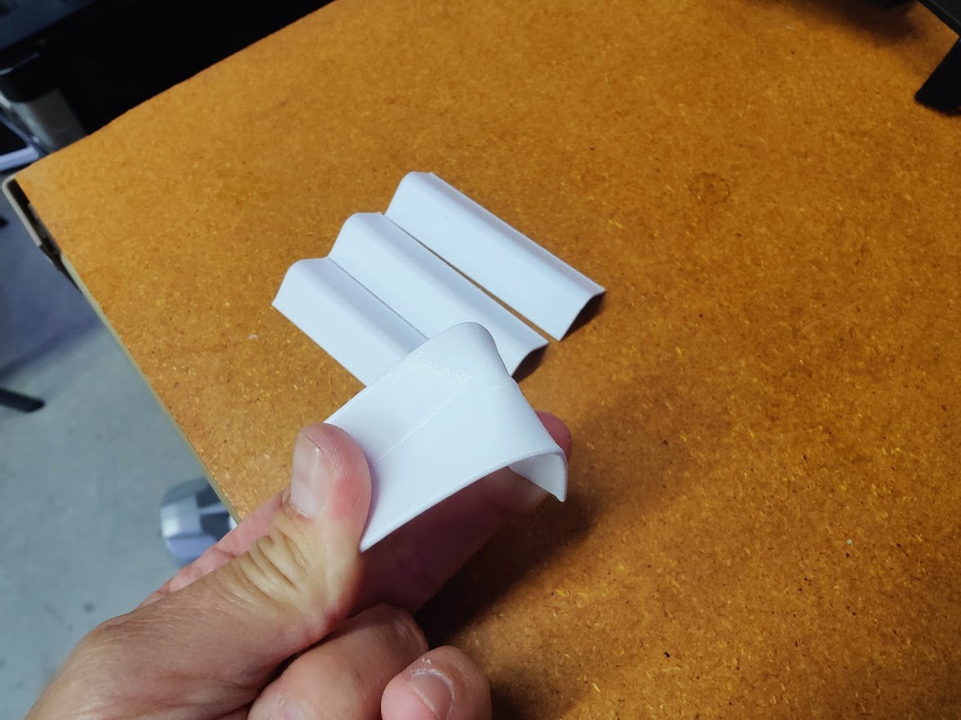

converging on the nice finger feel. this is version 9. larger dia and deeper groves.
Posts: 2088
Re: a couple printed widgets
converging on the nice finger feel. some versions... I like the last one because it feels good, very secure and comfortable in the finger. It's all for play! that's what I do. let your mind be free. :)

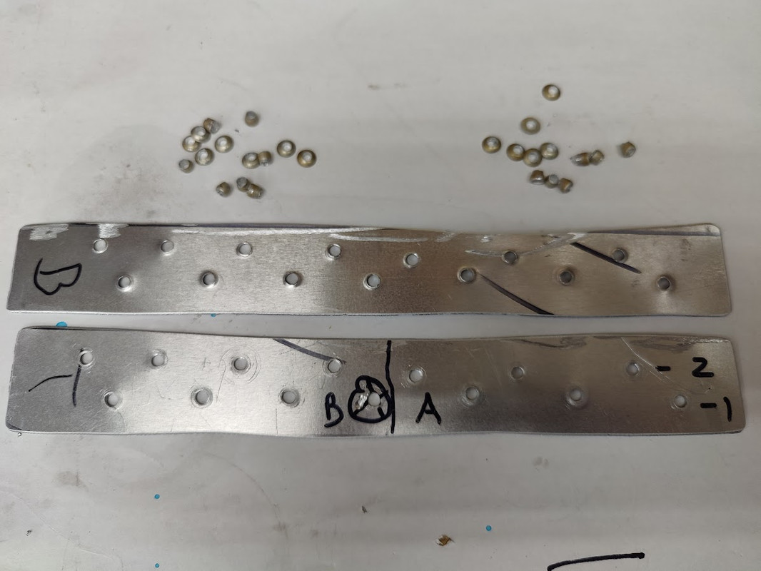

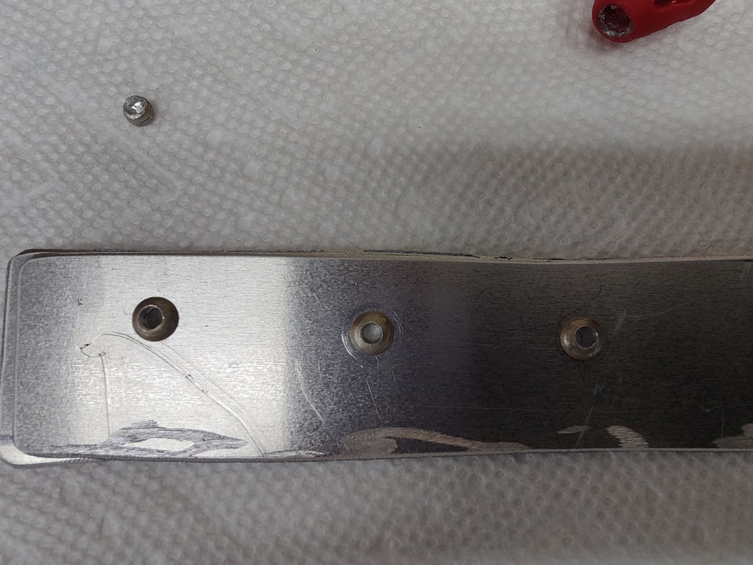

dome rivet drill-out finger tool... what about a path to shed the chips? the print needs some clean up but good enough for testing. I haven't tested any more of these finger tools since my first prototype.
Posts: 2088
dome rivet drill-out finger tool...hey, this wasn't too bad. drilled thru the center of each rivet. used punch to snap off the head and pulled the tail thru. it was easy. approx .010 inch on the sides of the tails. I didn't touch the sides of any rivet holes. the finger tool shed the chips well. some chips may have embedded in the plastic, so not sure how long the tool will last. drill tool size is .120 inch, #31 drill size.
