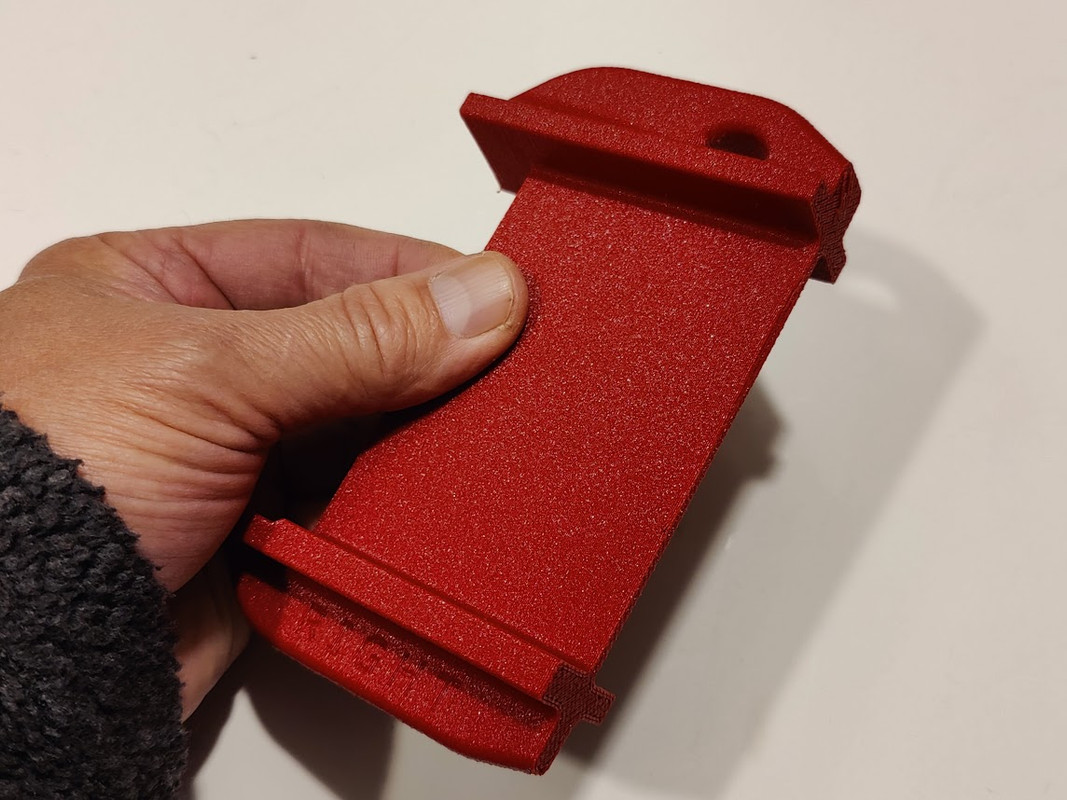

still evaluating the nylon / glass fiber material. right side elevator gust lock for my 9. this material is smoother than you would expect. so far, I like it. Obsidian by 3DXTECH from Michigan, strong and tough.

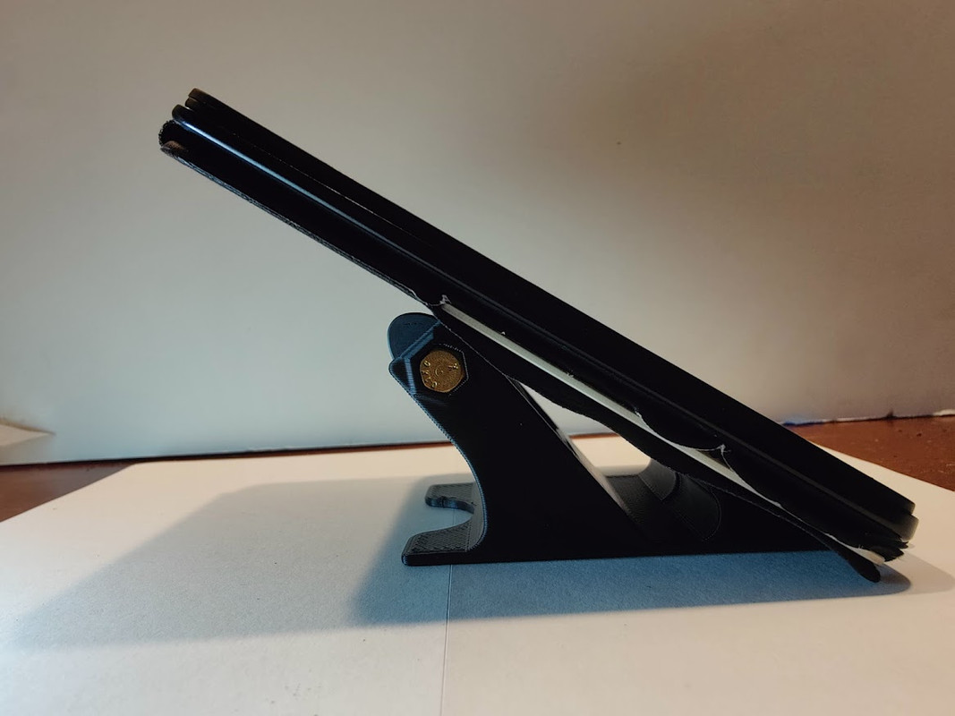

The ultimate adjustable phone and tablet stand. Allows one to set the perfect angle. UV resistant plastic. 9 months of testing in US and EU with perfect results. Black color base, grey color cam.

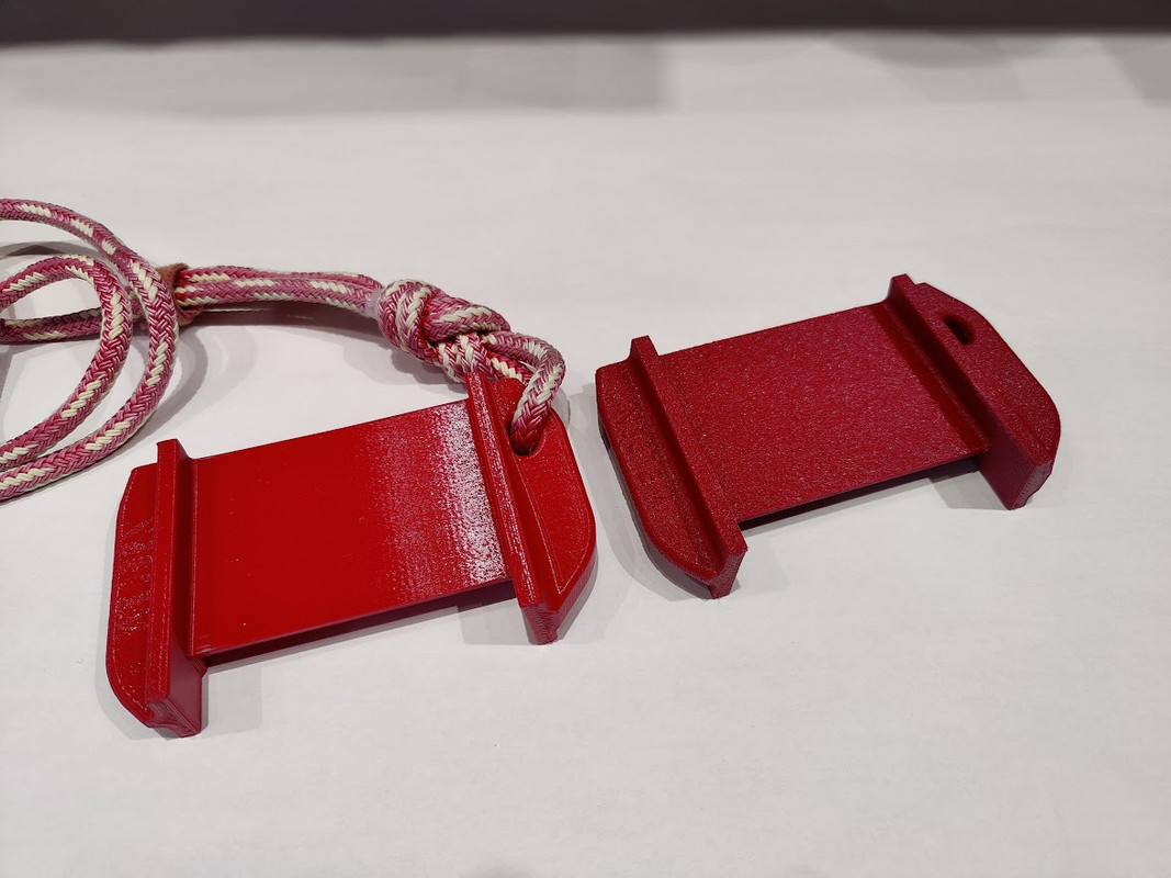

sending some RV7 elevator gust locks made using nylon/glass fiber material for evaluation. they are rougher than poly carb material but may have better durability. these are thin web, normally .068 inch but the nylon / glass fiber prints at .072 inch. it must be how the material spreads when it is deposited. hey, I keep trying stuff! it really is just a hobby and play for me.

replaced my right-hand side poly carb elevator gust lock with nylon / glass fiber to get some more operation time on these. now both sides nylon / glass fiber.

Carole's phone stand... upon request, I made a +1 inch extended trap to allow for better viewing when standing at a kitchen counter. I am learning people are particular about their phone stands. :) it's only one click to adjust the design.
I may try to add some ridges in the flat to allow for multiple trap positions. not sure if it will work...
not sure if this will work... best I could do with this idea without building steps.
Posts: 2088
Re: a couple printed widgets
the ridges didn't work very well but I realized with a slight adjustment the full range can be had using the cam. a fun little project.
fwd trap angle range = 32 - 46 degrees
aft trap angle range = 47 - 70 degrees
total angle range = 32 - 70 degrees
extended the fwd trap vertically slightly to compensate for the low angle. I think this wraps it up.

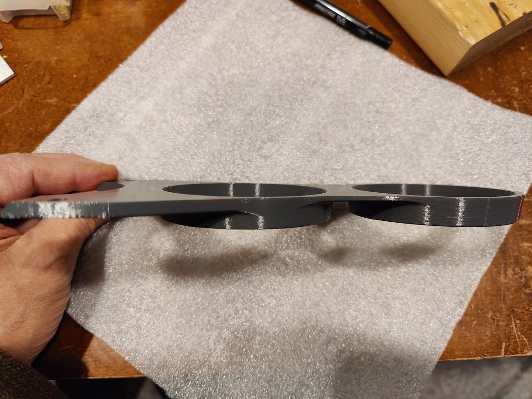

cup holder.... I have always struggled with achieving a perfectly flat surface on the upper viewing side because a print bed becomes damaged overtime and develops small uneven areas. I worked a process to achieve a flat surface on these. I am glad that is done. a small thing, but it was bugging me. working hard to become better every day.
