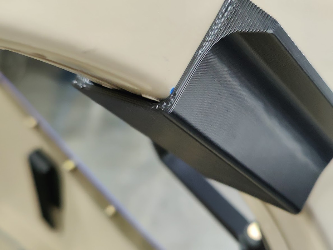

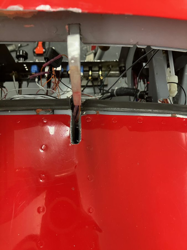

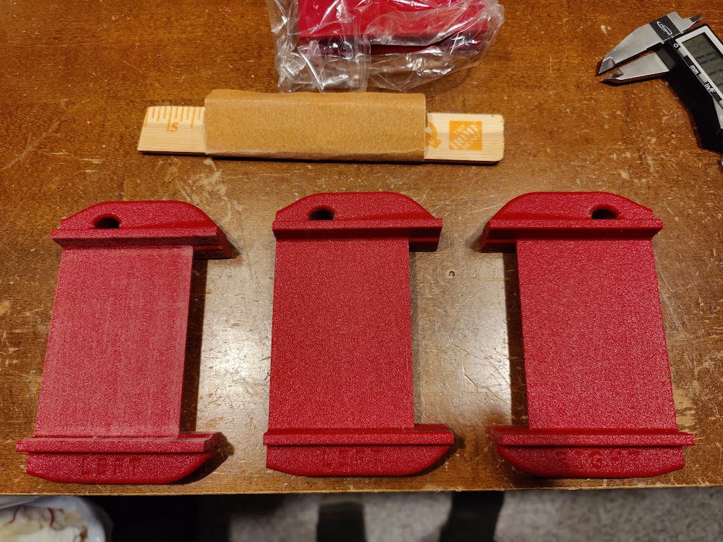

nylon / glass fiber elevator gust locks. these are thinnest web version I make at advertised .068 inch. however, the new nylon / glass fiber material measures .076 inch after print. after a light sanding, they measure .069 inch and feel smooth. so, I think this is a good prognosis for this tough new material for this application. especially for the thin .068 inch web version.
these are unique since the application is for an aircraft with a small fwd fairing and large (glassed in) elevator horn. you can see the step up in the profile.

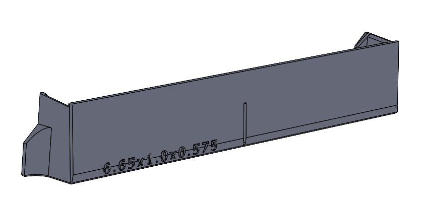

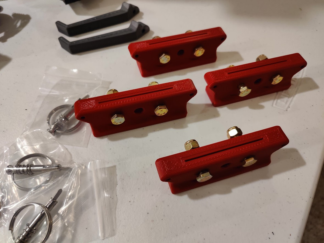

pretty parts. elevator gust lock ends for metal web version. good if the gap is small. the user makes the .032 metal piece.
heavier and clunkier than the plastic web version. very strong.

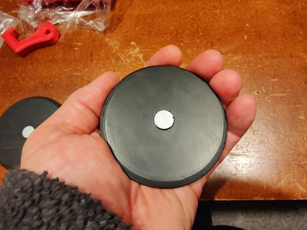

soon to be crossing the 2-1/2 year mark for the 3M Dual Lock test.... I am amazed. dog stake = 1.1 lb. the dual lock was fresh (1 yr old) and plastic scuffed lightly. it gets some vibration from the air compressor.

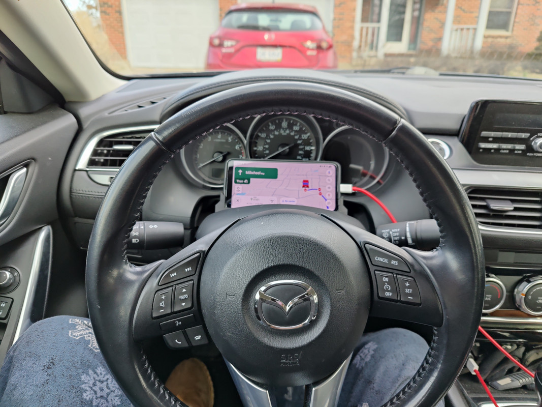

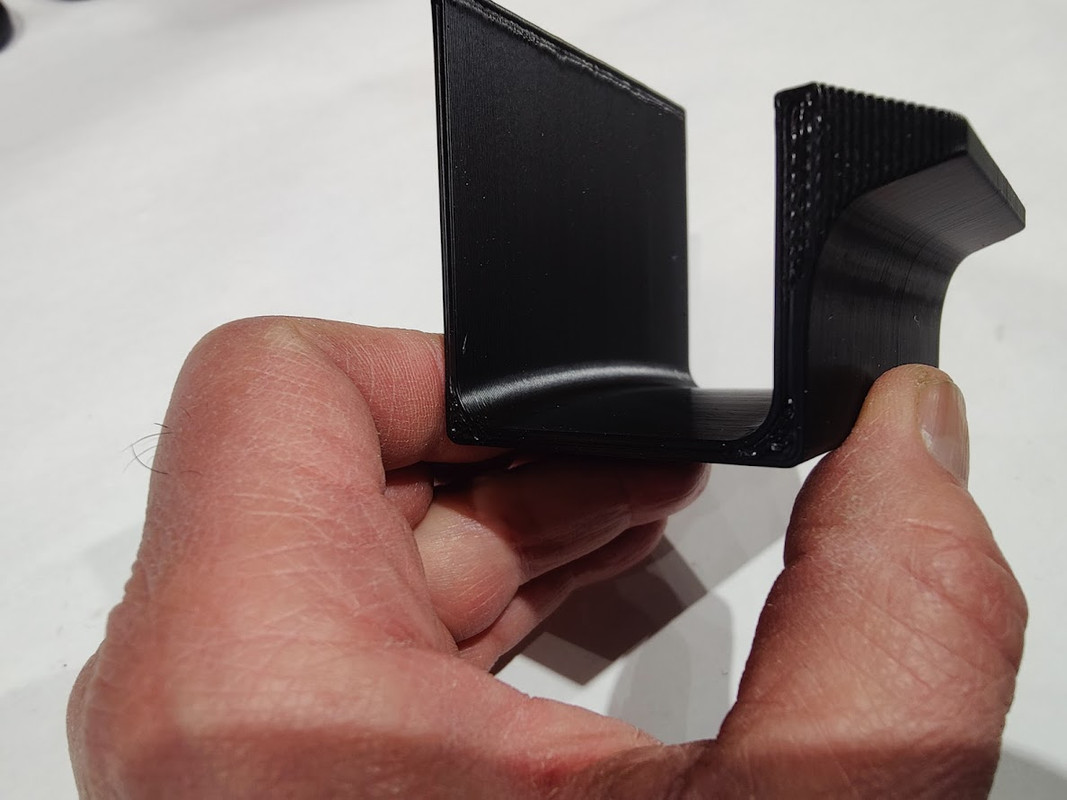

I always wondered what it would be like to have a phone mount directly in front of you, while driving. it seems to be OK just sitting there. time will tell during operation. easy in and out. note: I drive with the steering wheel tilt adjusted as low as possible.
something quick for me to try this AM. if it works well, I'll print one for my daughter, so it is easier to keep the eyes on the road.
edit: this is working well for me because my vision still sees the road even when looking at the map.

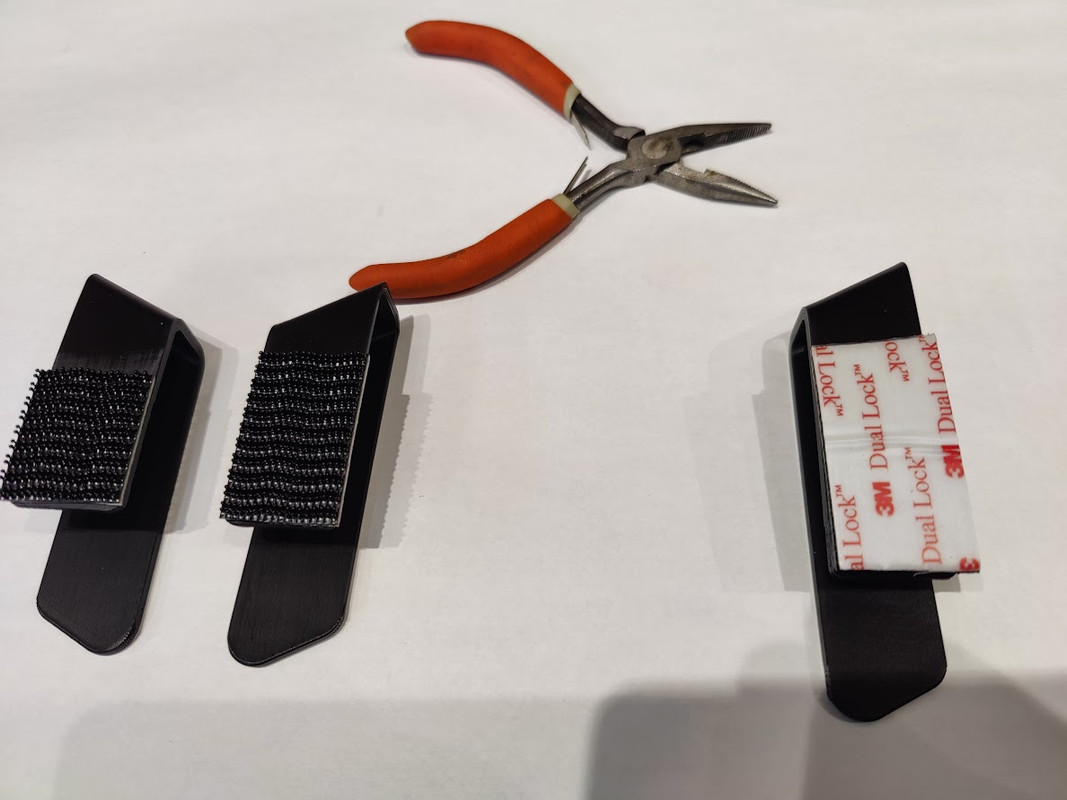

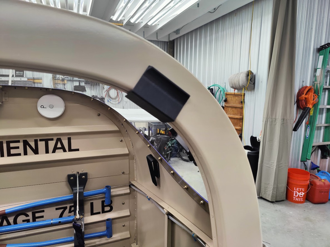

thinking of a hand grip to aid pull up on to the wing for entry. to be attached with 3M dual lock. after a long bike ride, I am tired and sometimes it is wet. loading the bike with an extra 20 lbs on my shoulder can be a challenge. so, any aid will be beneficial and could prevent a slip as I get older. the grip will attach to the backside of the tip up canopy roll bar. I'll make a prototype to understand it there is any benefit.
I am not sure if this is the best approach or if I can even install it. it is a prototype. set at the 45 deg but can be easily moved in the design to another angle. may not need as much 3M dual lock land as shown.

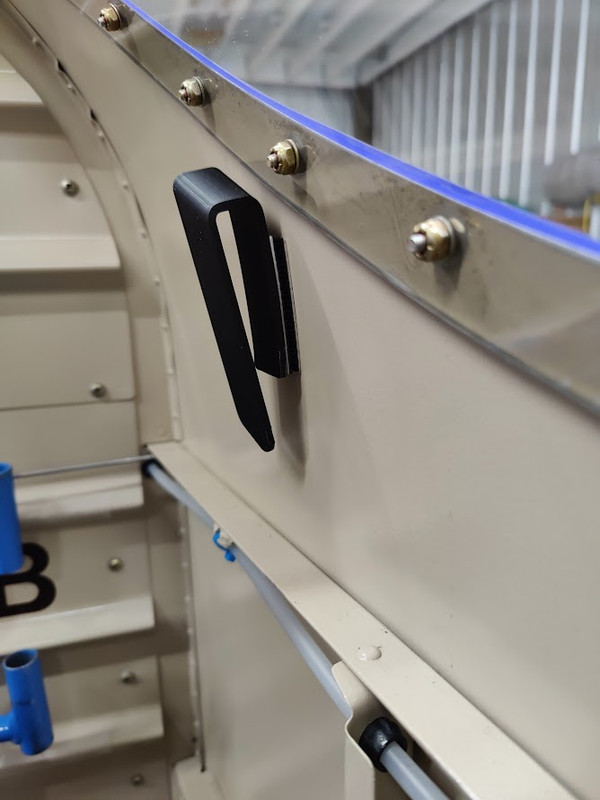

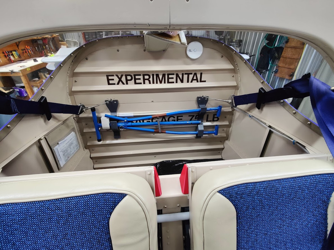

seat belt retainers.... I wanted 1/2 inch more length for both the belt side and the bonding side. I really like these for loading big stuff, like a bike. contoured to fit the skin between screws 6 and 7.

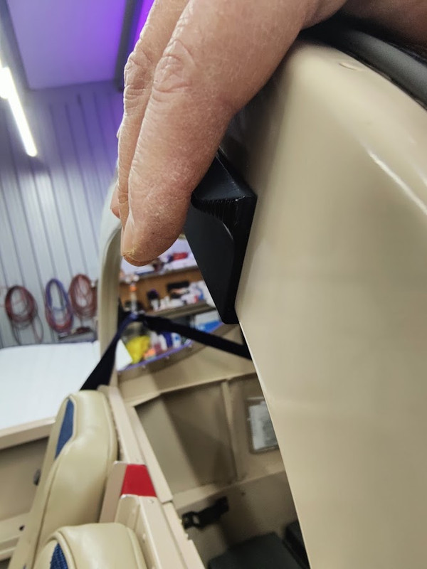

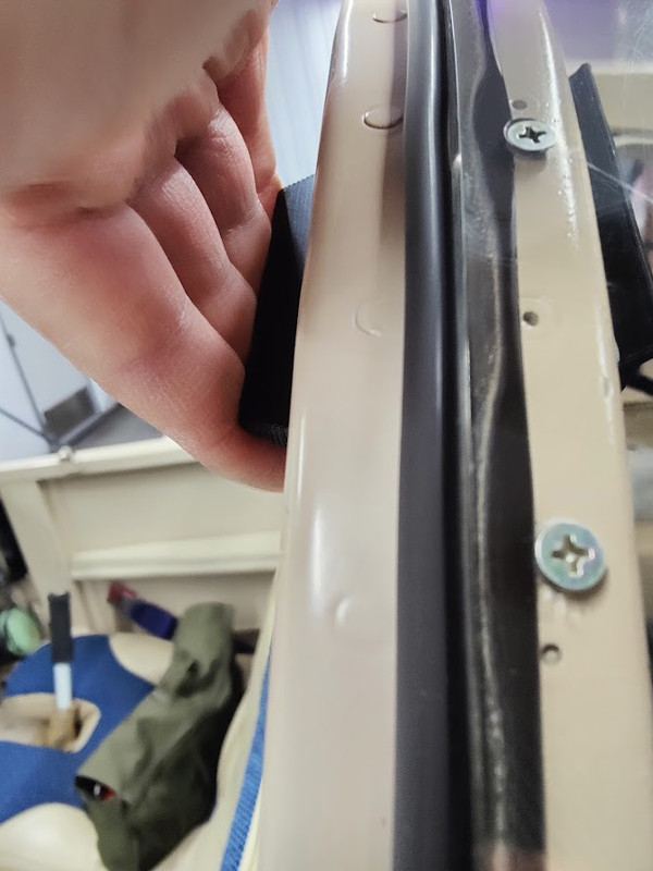

hand grip for tip up.... I installed this and really liked it. rock solid in the pull direction. I was swinging around like a monkey, thinking this is too good to be true, and it was. when I checked the clearance for closure, it did not meet 0.1 inch. in fact, it had a slight interference. I need to fix that because it was really good. it was easy enough to put on and take off 10 times.
hand grip for tip up.... worked the geometry for this and basically moved the grip upwards to clear. added a tang at the bonding side for easy installation and removal. grooved the underside radius to clear any protruding rivets. made slight adjustments to thicknesses. I'll print one and see if it works. if you are designing these at home and printing, I print these on edge for maximum strength in the pull direction.
looks OK. I'll test fit for function and clearance to understand if my geometry was correct and if I can swing on it like a monkey. fun stuff!
I threaded the needle on the geometry and the clearances are good. the grip is very secure, and I can swing on it like a monkey. the recess for the rivets allows the fillet to contact. I think it will be beneficial for stepping up with a bike bag on my shoulder. I'll test it for a couple years.
hand grip.... I was curious if the contact contour matched the roll bar thru the entire arc length. I had a scrap piece, so I cut a notch. the contour seems to match well.
