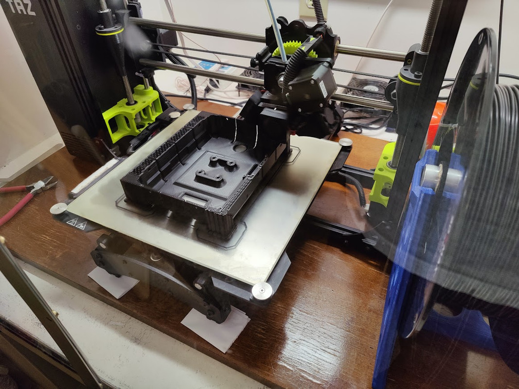

Pantheon HS3 is in functional check for new high temp nylon/carbon fiber material. printing some heat deflection test strips for comparison to existing nylon/carbon fiber. my first impression of the HS3 is good. dimensions are spot on, and it is fast. print temp is above 300C. print tool head is 100W.
Posts: 1877
Re: a couple printed widgets
well, the HS3 printer accuracy is better than the TAZ. this model needs to dialed-in for the new printer accuracy and some design updates. I am still working to determine the max temperature capability of this new material. it was supposed to be higher temp capable, but I am not sure about that yet. high temp testing is on-going. the current material I use for these has longer carbon fibers and needs to be printed with a larger diameter nozzle. the new nylon for this part is PA-12.
a very clean print for high temp nylon/carbon fiber.... printing above 300C.

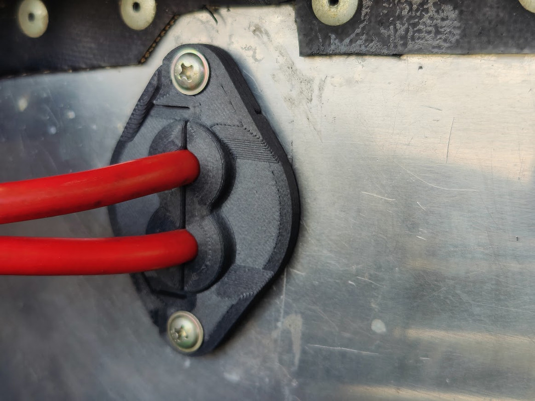

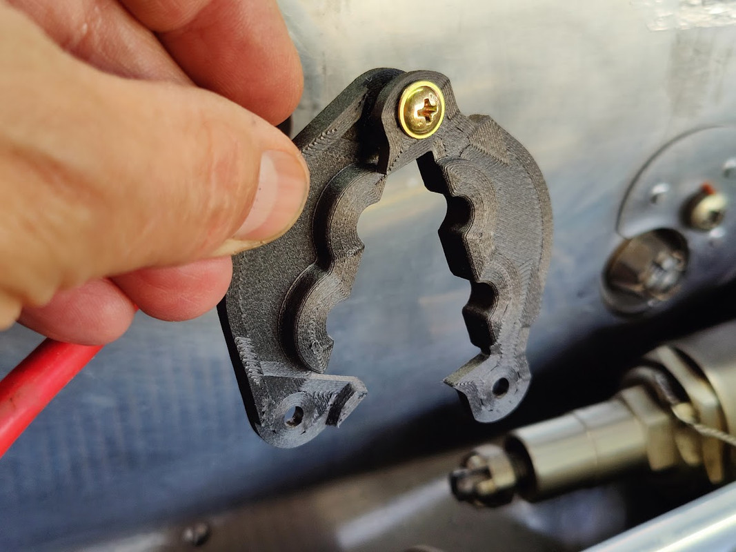

Posts: 1877
installed for testing. easy to install by installing one screw and then clamp around the wires and latch it (it designed to latch easily), then install the opposite screw at your leisure. it fit perfectly in the close tolerance existing baffle screw holes and grips the lead wires well. the removed wire seals are in excellent condition but not as pretty as the new style.
removed wire seals after 4 years and about 400 hours. they are in excellent condition .....
installed new wire seals for testing.......

flight testing is going well for these spark plug lead seals. I modified the design to eliminate the latch to eliminate the chance of someone cranking the screw down on top of it and causing damage to the seal. flight testing seals is a nice job!

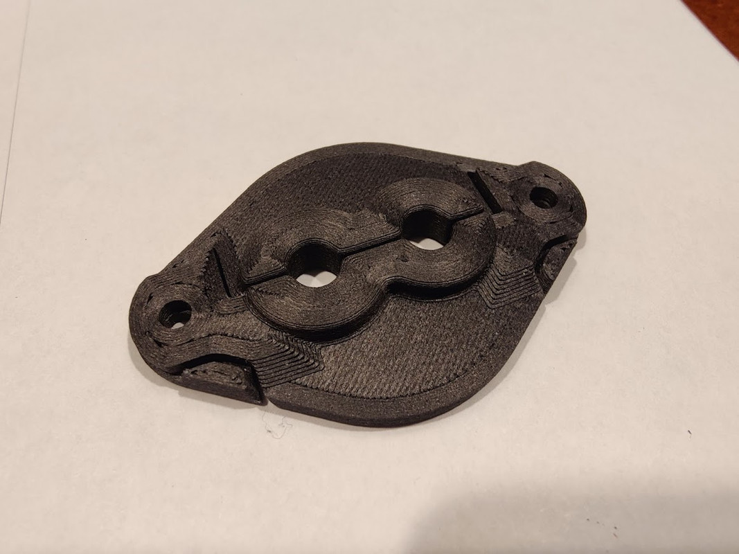

is there any reason the spark plug leads couldn't pass thru at an angle, if you wished?
need a good drill tool to get it perfect. I can do that. something like this one but an offset center hole.

Posts: 1877
the first off angle spark plug wire seal. not too bad. a nice day today, 90F, climbing out. testing wire seals is a nice job!

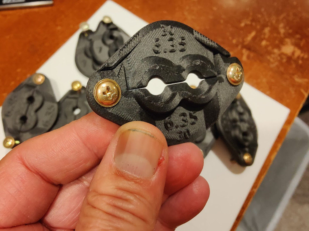

Posts: 1877
spark plug lead baffle seals - 20 degrees off angle test fit
the 20 degrees off angle seal resulted in a smoother wire lead path. comparing 20 degrees to zero degrees....
7mm 20 degrees
7mm zero degrees
Posts: 1877
taking a look at the 7mm 3-hole spark plug lead seal design. preparing these for an offset angle. hey, why not.
these are good to 300F. a compact design.
with a printed drill jig, the install time for one of these is about 10 minutes.
exact same mounting hole center to center dimension as the slick version... and I mean exact! 2.250 inch.
