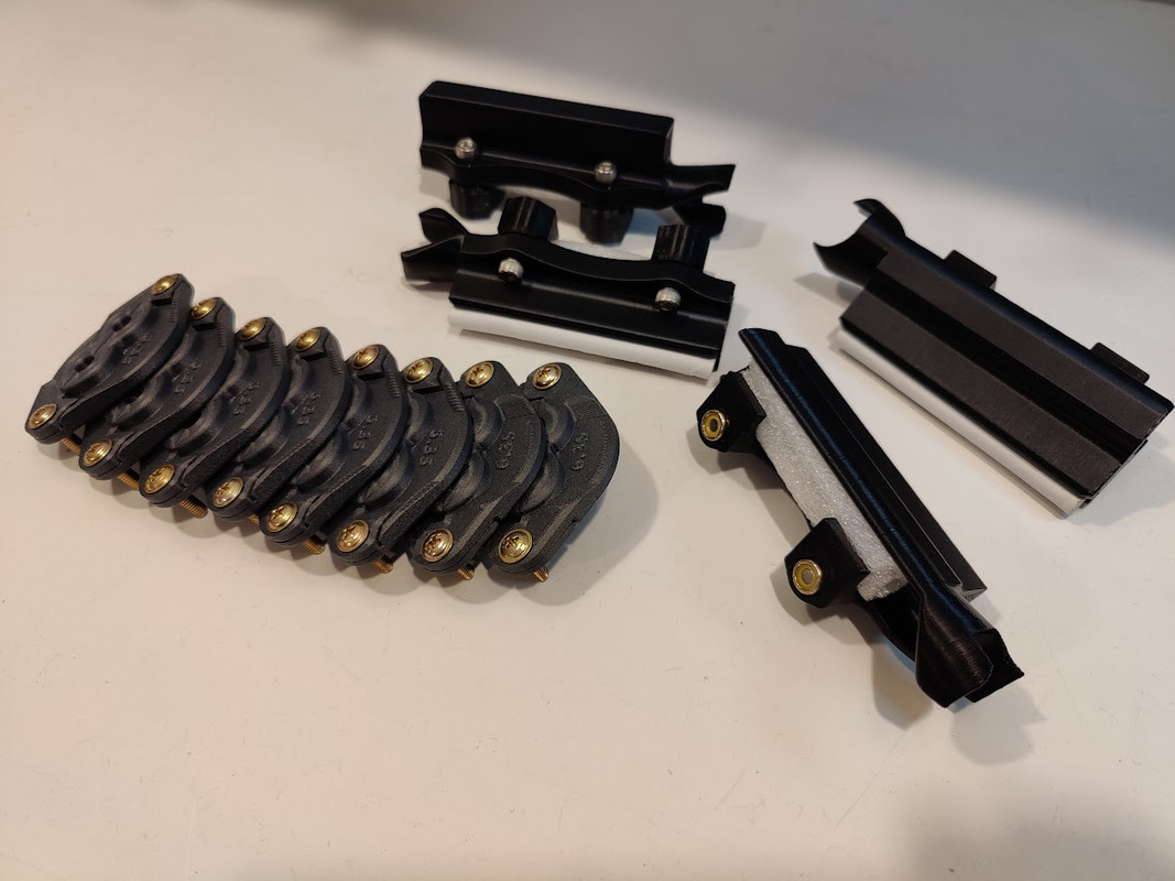

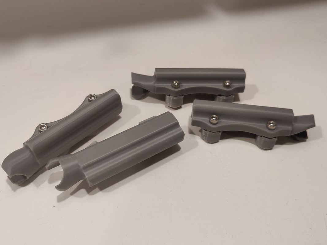

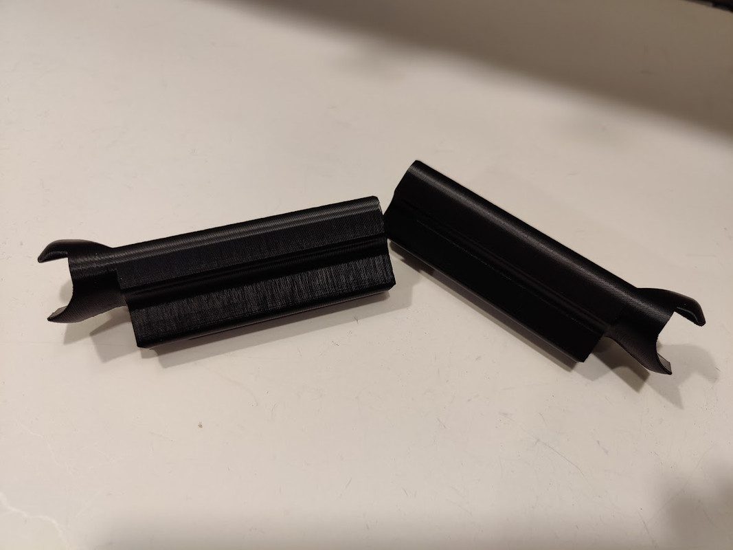

Initially I believed the flat style rudder pedal extensions would be the most popular. Nope, the round style has far surpassed the flat.
Posts: 2120
Re: a couple printed widgets
printing some things this AM.... more rudder pedal extensions, big and only 46grams each. push them on until they "click" around the vertical bar. I need to raise the price on these extensions to slow the train.
and more...

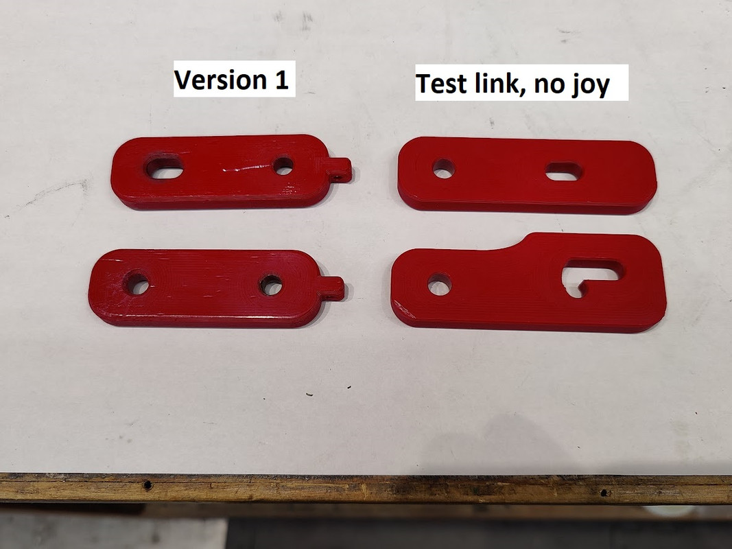

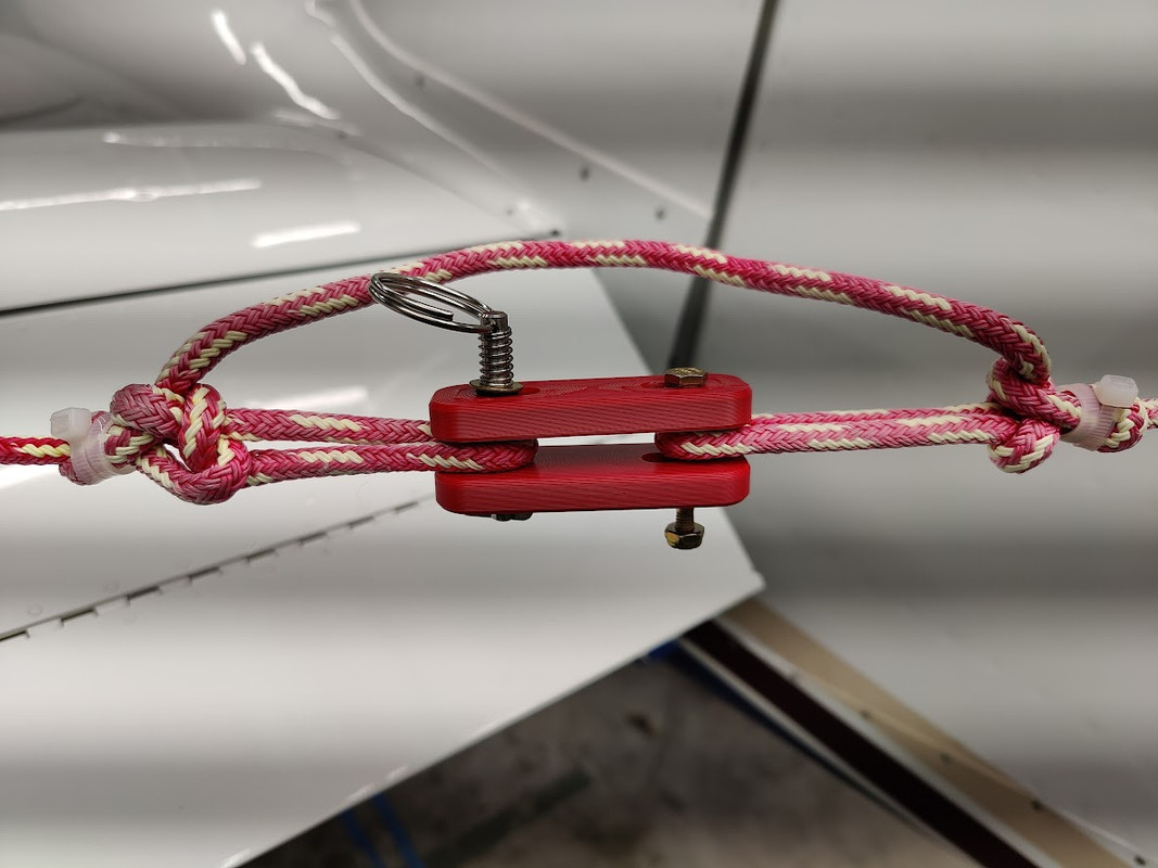

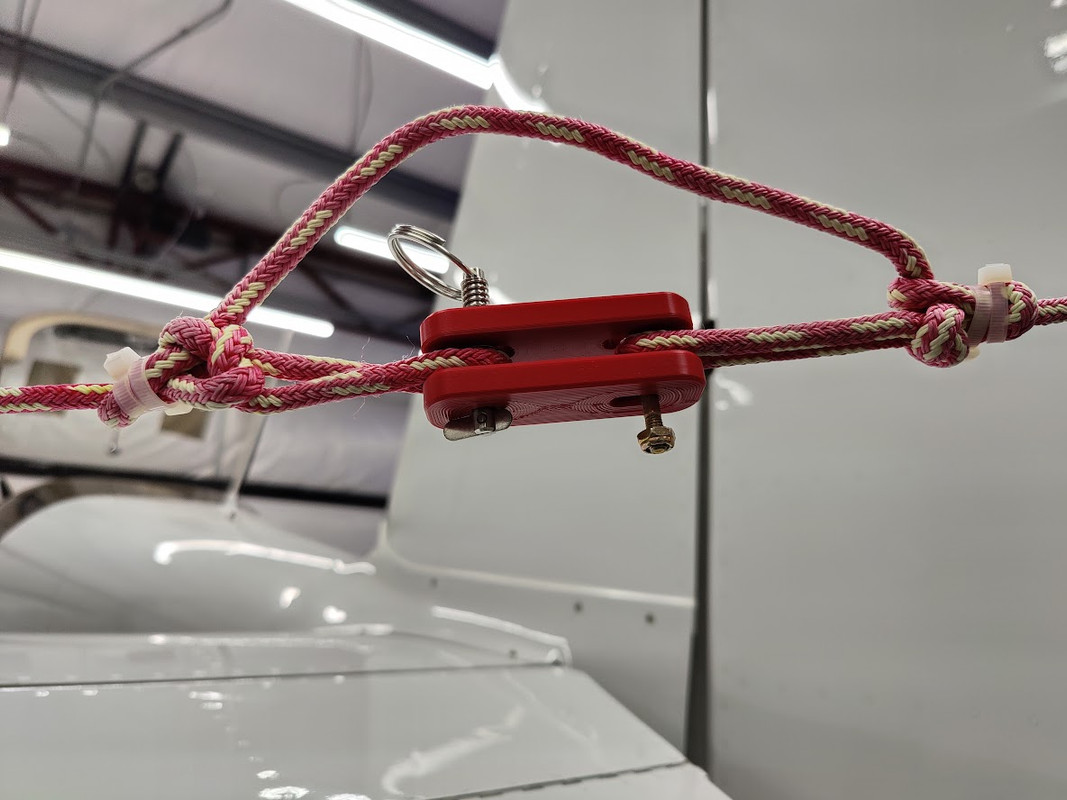

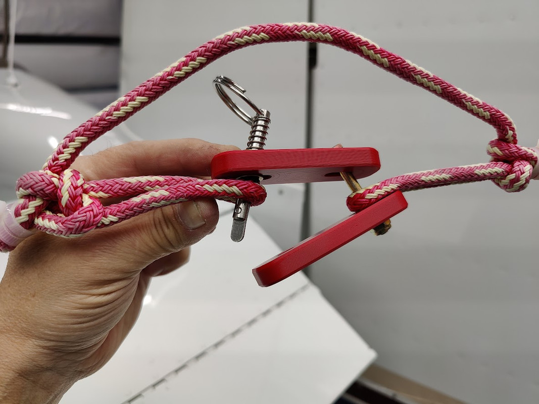

rope link Version 2.... when it is very cold, the rope shrinks and makes it more difficult to link. this version changes a couple holes to slots at the bolt for ease of fastening. it seems to work well. I like it. I'll test it for a while. the rope is about 5 years old.
Version 2, Rudder Gust Lock, Rope Link.... I slotted the holes in the links at the bolt side to make it easier to fasten the cam. It works well and I like it so I thought I would convert to a stainless-steel bolt and nut and add silicon o-rings for the cam lock retention to make it snazzy. :)
SS is about 1/3 the strength of an AN (grade 5) bolt. in this case, the SS -10 bolt in double shear is capable of 1000 lbs. that is a close to a 10X safety factor and you don't have to touch a cadmium coating.
