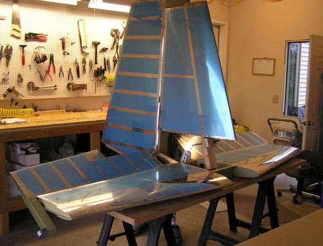

All metal work complete. Time for the fiberglass :mrgreen:

Looks great Will, aside from the fact your elevators are on backwards.
...and where is that pesky little trim tab!?!

I didn't think it would take very long for you to notice that CJ :lol:
Actually, the HS and both elevators are upside down in this pic. It was just easier to set it up this way as the control horns stick up (instead of down into the table). I also fogot to put the trim tab on :bang:

Lookin' GREAT Will!! I never did set mine up to take that pic... :roll:

Thanks guys :mrgreen: It actually took longer than I thought it would to set that up but I need to be taking more pics.

Now that your mostly done with it... Peel all the blue plastic off of it.
I forgot to peel mine, and even though I kept it high and dry, there were a few small areas on the trailing edges where the blue plastic had an air bubble or two and after 2 years of hanging there, I noticed a slight bit of corrosion starting to appear.
Everywhere that the blue plastic was firmly adhered to the skins were fine, but if you have anywhere where air pockets can get trapped underneath, it can be a problem over time.

Nice photo Will , but arne't your elevators on 'upside down'

Thats afirm :mrgreen: The whole horizontal assy is upside down. The tail isn't even on the fuse yet and already it wants to go inverted :wink:
