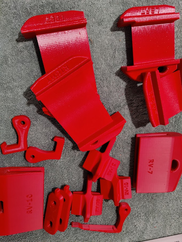

outside lap seat belt holder. needed to choose one of the three finalists. I chose the middle one and buckled up and went for a flight. I never looked for a single belt. just reach and it's there. very easy to stow and secure. I like it a lot! clean baby. one less thing to think about before a flight.

must be the season for speed. wing tie down fairings and drain fairings. drain fairing are improved from the original I made 4 years ago, strengthened design and material change to resist fuel seem to be doing the trick. my right hand side fuel drain fairing is 4 yrs original, my left hand side had weeping fuel and developed a crack, replaced with new design and working well.

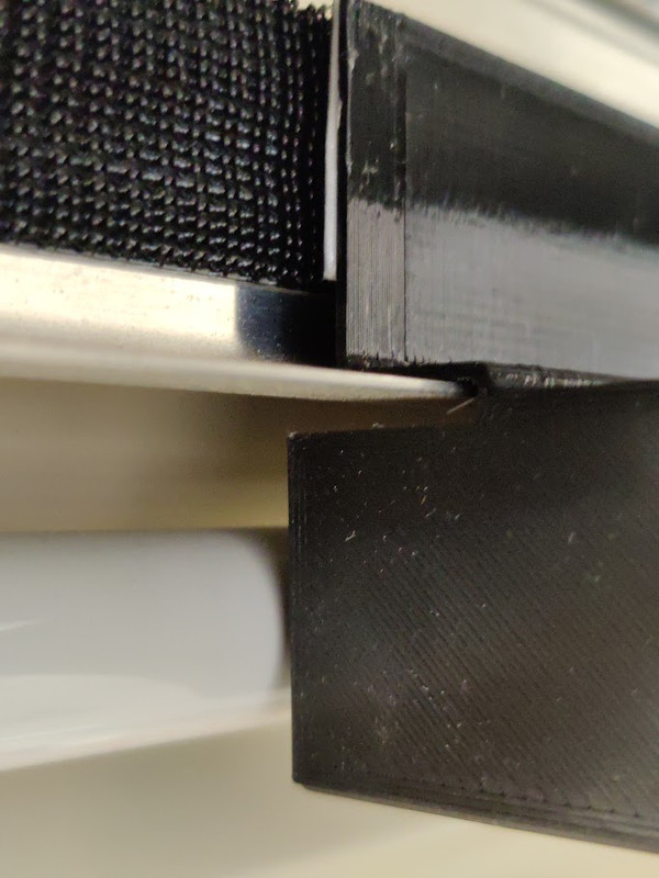

Seatback bar storage.... prototype. I'll try something like this. total printed weight = 40 grams.
everything fit nicely, just like the CAD fit. first printed parts were installed. material is thin, strong and the total part weight was 38 grams. a quick job. reach back with the right hand, put a finger in between and rip them out of there very easily. I see how they fare when I really load the baggage area, but I think they will be mostly out of the way. fun stuff.
it is really nice to be able to model it because it reduces trial and error. boom, you are done. from concept to install for this one was 28 hrs. the Kansas nose wheel chock is now squirreled away and the areas around the seats are clutter free.
for an alternat part, I may close up the ends and make a long tray for the opposite side for storing knickknacks.
Posts: 2282
Re: a couple printed widgets
seatback bar storage tray.... concept.
I'll give this concept a test print.
Posts: 2282
seatback bar storage tray.... done. thin, flexible and strong. I moved the chocks to the pilot's side because I can easily get them when I exit the aircraft and I thought the tray could be better served on the co-pilot's side. I popped them on and off several times and it was easy and yet very secure. I'm getting things cleaned up. I like this 9. weight of the tray = 50 grams (0.11 lb). time for some test flights. :)

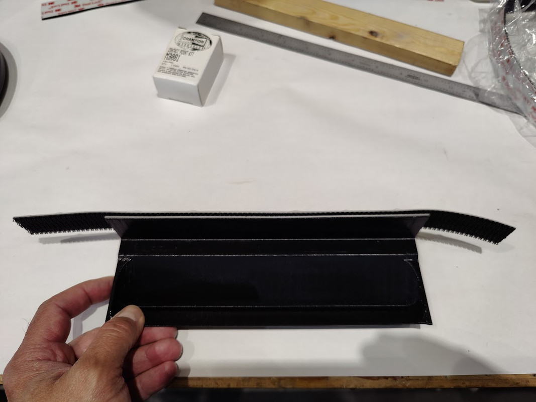

seatback bar storage tray. so naturally, the request is to make it bigger to carry more "stuff".

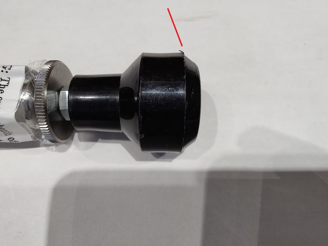

throttle knob. I installed a new throttle cable recently and I removed the supplied knob and replaced with the printed one I had been using. I threw the suppled knob in the trash. I also ordered a spare throttle cable and I looked at that knob today. no wonder my hand would hurt after a flight with a knob like that. best thing I ever did was to get rid of that knob.
seatback bar storage tray. first one to print and installed. I had some warpage at one end of the tray, but I think I know to correct that in the future. I cut the warpage off. the weight for the final version of this tray is planned to be 79 grams. popped the smaller tray out and installed the new tray. just another place to store stuff that doesn't add much weight and it is accessible in flight. printed in 3 hrs. some work still needed to clean it up. hey, I could put my cigarettes back there! :)

someone tried the RV9 seat belt strap holders in a 14. the first I have seen. I made the arm slightly longer for the 14.
Posts: 2282
tis the season for gust locks. elevator locks are polycarbonate. it's a tricky material to process but is strong.

seatback bar storage tray.... bigger. running high speed and I expect some ringing from head dynamic deflection (should show up well on gloss black). projected print time 2.5 hrs, less the end cap. then assembly.
hey, this worked very well. I'll install it tomorrow.
