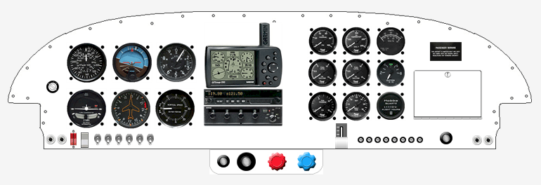

I only have the trial copy of the software right now. Looks like it is on sale now for $29.95. I may have to get a "bonified" copy. I'll get back witcha' on that. Here's what I have so far. Oh, I just noticed I forgot to put a tach in the mix. Dang it! :bang: The total cost so far is $6,243. Not bad...

Shoot, you have a long way to go...Mine so far is $36,480 (retail)...

smithhb wrote:Shoot, you have a long way to go...Mine so far is $36,480 (retail)...
[/img]
OMG!! :o :o $36k in your panel!! I feel sheepish...
Mine is a little higher than Smitty's at $11,372 for this-

I spoke with Fabian (Affordable Panels) yesterday and he can take your design in XPanel and laser cut it for you. For the $$time$$ this is a great option.
Here is my current leaning...
The *discounted* price for my panel is around 20K.
Bret Smith
9A Flying (N16BL)
Blue Ridge, GA
Bret,
Nice design!
I really like it!
:wink: CJ
