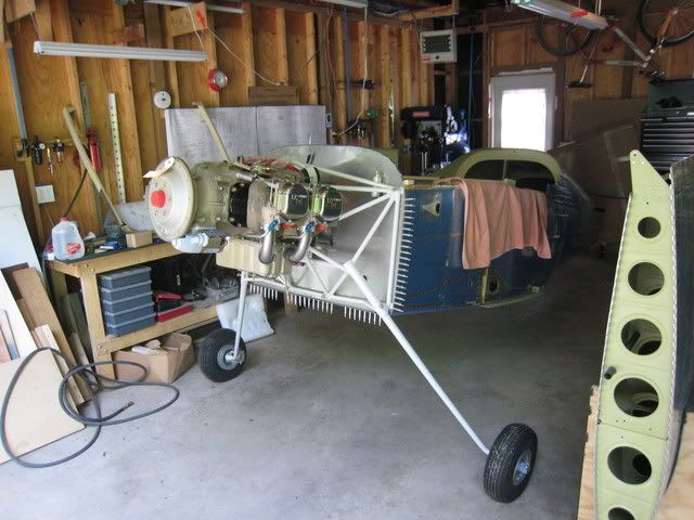

Friday was a big day that I had been planning for over 2+ months -- Engine Hanging! My friend Andy was in town from Chicago, along with local RV-7 builder Bill Rogers and RV-4/8 builder Jack Savage. Jack got to my place an hour earlier than I asked him to get there so we started getting everything prepped. We ended up turning the fuselage around so just a little bit of the nose was in the garage, and the tail was outside. This gave us a lot of nice smooth concrete to make wheeling the engine hoist easier.

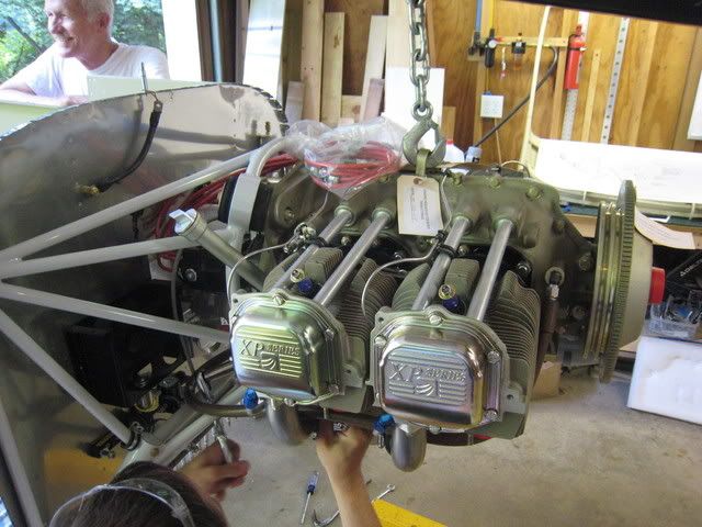

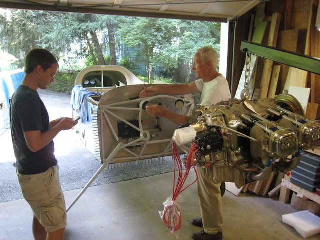

We pretty much followed the Illustrated Guide to Hanging Engines (on Doug Reeves' site), starting with the top right bolt first. This one was a piece of cake to get in. Took 20 seconds. The second bolt is the top left and that one gave us a real fit. Bill showed up about 20 minutes into fighting with the second bolt and took control of the situation. Bill has hung a bunch of engines before and did his SOLO on his RV-7! After tightening up the first bolt and pushing the engine, the bolt was in! The bottom two bolts went is pretty easily once we let the engine down and compress the bottom mounts. Here I am tightening up the last nut.

Here the final pic of the plane with the engine on and backed into the garage again!
