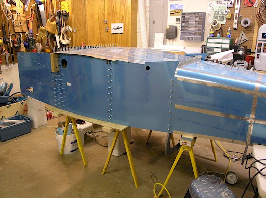

I drilled the holes this evening with an 1.5 inch bit. Here they are clecoed to the fuselage.

Are you sure your flaps will clear??? :?: :?: My fuselage was the Q build and I didn't mark and drill the holes until I fitted my wings. Hopefully Van's has better recomendation for placement of the steps then when I mounted mine. Check it before you rivet it all together because it can be changed now or even the skin replaced before you rivet it.
Posted: Thu Jan 22, 2009 9:50 pm
by RV9inIowa
My skin had a prepunched hole for the flap tube center.... at least that's what I thought it was for :o
Posted: Fri Jan 23, 2009 8:52 pm
by Bob Barrett
I hope that is what the prepunched hole was for also. My kit was shipped in 2001 and was an RV-6Q so things probably have improved greatly!
