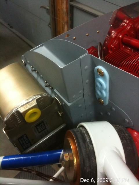

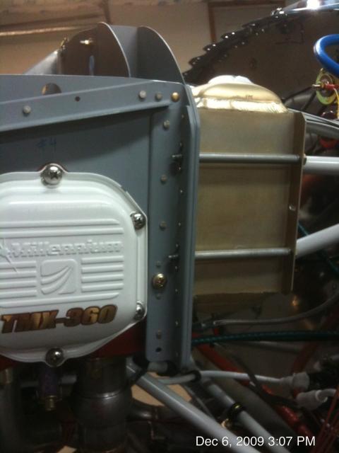

The first thing I want to point out is something that matches exactly what Brian (Chesteen) ended up with after the first several hours...cracked baffling at the oil cooler. I noticed mine was cracked about a half inch after the 5 hour oil change, but between then and hour 25, it had progressed to about two inches. From 25-30, it ended up like this...
I'd say another hour or two, and the oil cooler would've been dangling off the back!
