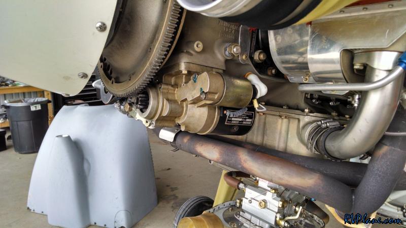

Yesterday when I attempted to start my engine for an evening flight, I experienced a kickback. I do occasionally get a kickback, so I thought nothing of it until I tried to start the airplane again, where I was greeted with just a noise coming from forward of the firewall without any movement in the propeller. I said a few choice words and pulled the RV back into the hangar to decowl.
Upon removal of the cowl it was pretty obvious what the issue was. The cast casing on the front of the starter surrounding the bendix cracked when the engine kicked back.
I know I am not the first one to experience this, but it sure did suck! However, it couldn't of happened at a better time or location. I am going to take this "opportunity" to upgrade my starter. I have never been thrilled with the starting power. Many times it couldn't even spin the propeller around a full rotation. I always assumed it was due to the awesomely high compression my kick-butt engine had. Perhaps it's just always been a normal engine with a sub-par starter.

Someone gave me a *free* B&C starter the other day with the caveat that it didn't seem to produce all that much power. As most of you know, I have a hard time refusing something for free (hence my callsign "Halfprice"). I cracked her open last night and discovered there was a TON of oil in it, especially on the brushes. I cleaned up everything and it looks brand new. I am off to the hangar now to install it and hopefully be back in the air.

Holy cow, the B&C starter is a BEAST!
It turns the engine over WAY faster than the sky-tec could ever do. I think the propeller could spin fast enough to taxi with! It's quieter to boot! I had no interference issues when I reinstalled my lower cowling. Spend the money on the B&C starters. It's totally worth it.

I decided to send in my Sky-Tec starter to see what the repair estimate will be. If the repair estimate is reasonable (it should be free since it never worked right), I will get it fixed so there is an extra spare starter on the field for anyone who needs it. The gentleman on the phone seemed to think there was always an issue with the starter since it never spun the propeller all that fast. My argument was the factory faulty starter caused kick back, since I have checked my impulse coupling is working on my Slick magneto, and both mags are times properly.

I just received a call from Sky-Tec and they agreed to fully replace the starter for free. They indicated it was an older starter, and the new ones fix a lot of the issues I had been having. I am torn on what to do now - keep the B&C on, or toss the fixed Sky-Tec back on?!?! Nevertheless, great and quick customer service from B&C. They called me the day they received it, and let me know it would ship out tomorrow! A great stand-up company!

I've thought about selling it, but in good conscious I can't. Since I received the B&C starter for free from a fellow RV'er at the airport, I am going to keep the Sky-Tec as an extra in my hangar for the next person who might need it at the airport. I am going to conduct an experiment and toss the new Sky Tec back on the RV to see how it performs with the updated design.
