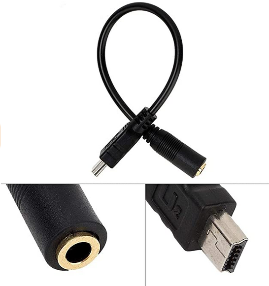

The signal voltage levels this circuit outputs is definitely compatible with a GoPro, you will just need use a stereo 3-conductor 3.5mm plug wired slightly differently, and a 3.5mm <-> USB Mini connector similar to the following:
(Ebay http://www.ebay.com/itm/Mini-USB-3-5mm- ... SwnDxUkoPE - $1.39 shipped from HK)
12/2022 update (above ebay link is no longer valid)
https://www.amazon.com/ASHATA-Camera-Ad ... B07YWVPRFK
