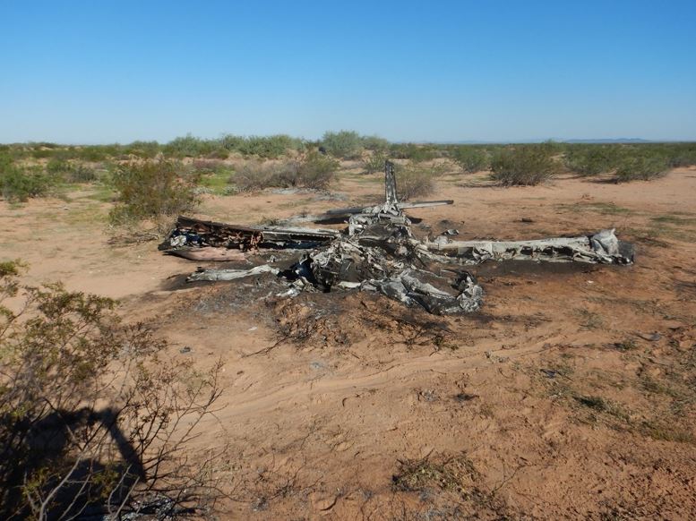

Van's RV-6A, N646RV: Fatal accident occurred September 16, 2022 in Aztec, Yuma County, Arizona
National Transportation Safety Board - Accident Number: WPR22FA348
Federal Aviation Administration / Flight Standards District Office; Scottsdale, Arizona
Aircraft crashed under unknown circumstances and caught on fire.

it is strange that no radio calls were made for this event. in a situation such as this, it is best to make radio calls because personnel are standing by to help. if you are busy, try to get at least one signal out that you are having trouble and your approximate position. why did the pilot maneuver away from the road, it appears this would have been a landing option since it was straight, flat and probably not busy. impact gouges in the starter housing both in-plane and aft of the gear. they will need to dig into the engine paperwork.

On September 16, 2022, about 1330 mountain standard time (MST), a Vans RV-6A
experimental airplane, N646RV, was destroyed when it crashed near Aztec, Arizona. The pilot
and passenger were fatally injured. The airplane was operated as a Title 14 Code of Federal
Regulations Part 91 personal flight.
According to family members, the pilot and passenger were conducting a cross-country flight
from San Diego, California, to Nogales, Arizona. Automatic Dependent Surveillance –
Broadcast (ADS-B) data indicated the flight departed Brown Field Municipal Airport (SDM) at
1209. The flight flew easterly, parallel to Interstate 8 (I-8), and maintained an altitude of about
7,300 ft mean sea level (msl) and 125 knots until it neared Aztec, Arizona. At 1331:19 airspeed
and altitude began decreasing. The pilot subsequently maneuvered away from I-8 for about
one mile and then turned east and south-east before the ADS-B data ended in the vicinity of
the accident location at 1334:28 (figure 1). The airplane impacted desert terrain about one mile
north of I-8 and was destroyed by postimpact fire. There was no evidence the pilot declared an
emergency or made any radio calls prior to the accident.

well, they could not determine why the engine failed. if I remember correctly, they had recently purchased this aircraft, and this was their first trip. fully loaded the RV6 glides like a rock and the pilot turned away from his landing spot. when he did this, it sealed their fate.
The total loss of engine power for reasons that could not be determined based on available evidence. Contributing to the accident was the pilot’s decision to turn away from a suitable emergency landing surface, his failure to maintain adequate airspeed as the airplane neared the ground, and his exceedance of the airplane’s critical angle of attack, which resulted in an aerodynamic stall.
