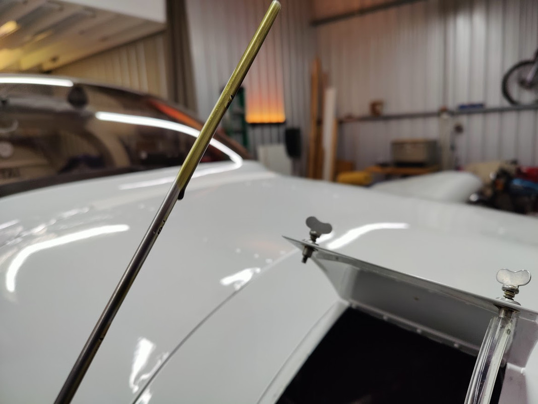

I decided to remove the cowl to determine how much -6 and -8 hose to order for hose replacement. while I was in there, I checked my remote exhaust ball joint oiler tube (looks good) and sprayed the rubber parts with AT-205, a plasticizer. all rubber parts are 10 years and looking good, all original. I saw a YouTube video by Vic Syracuse, Base Leg Aviation, about drilling a hole in the fuel vent aft side and I thought it was a reasonable modification, a Vic Trick. I used .060 diameter which is plenty. I always watch Vic because I like his style. I use fuel vent bug blades in the Summer but remove them for Winter in case of icing. I have an upcoming trip across the plains in February and I know the weather can be bad. I re-oiled the air filter through the snout with a syringe and cleaned the housing with a paper towel on a stick.
