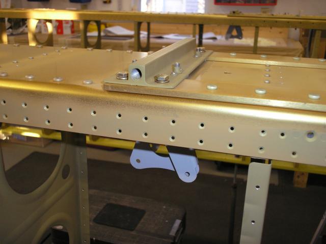

Today I removed the clecoes holding my wing skins in place and am prepping for the skinning process! I countersunk and deburred my spars and started deburring the skins.
I also made a cool dimpling setup surrounding my DRDT! It will make the whole skin dimpling thing MUCH easier as the sheet handling will almost take care of itself!

This setup ROCKS!

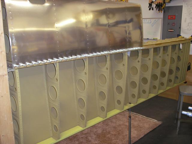

Well, the week is over and I do have something to show for it!
I dimpled the rear spars and main ribs (by hand because Fred has my pneu squeeze):
...spot primed the spars:

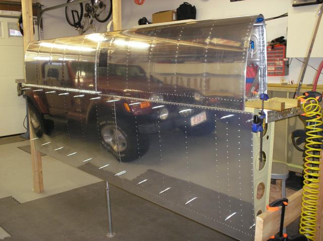

...painted the skins that I dimpled earlier in the week:
...and hung them!
I would say it was a productive week! This whole thing needs some noodling over before I get to riveting, but I am happy to have had this week to get this much done!
