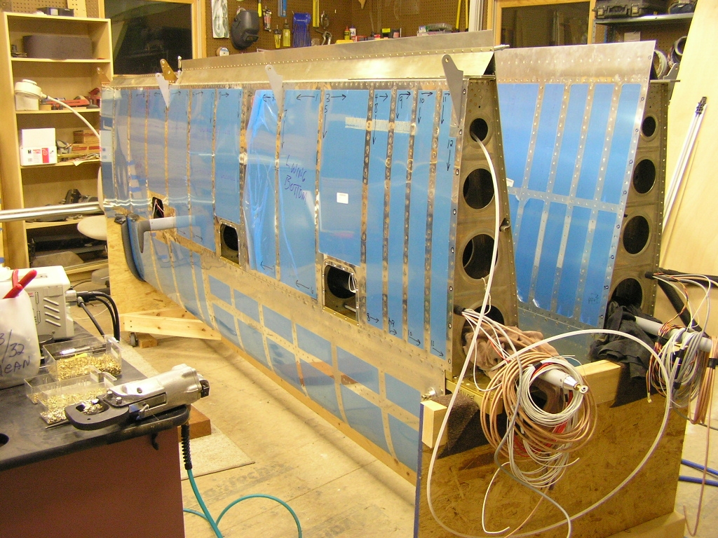

I was wanting everyone's help with a dilemma. A friend of mine was riveting the bottom skins on his wings this past weekend and accidentally dropped his bucking bar. The wings were in the wing stand and the bar fell through to the leading edge, third bay from the tip.
The area is accessible through the access holes in the spar but with the bottom skin riveted on, it can only be accessed from the end of the wing. Unfortunately, it is just out of arms reach.
Since this is an RV-9 wing (amazingly, the same model as I am building) I would like to help him with this problem so I am coming to the experts for ideas. Please don't suggest adding 3lbs of ballast to the other wing for balance...this has already been suggested and rejected as a solution.
Here is a pic of the wing. The bay is the third one from the left, one bay to the left of the access hole (which is impossible to reach through due to the ECM bracket and bellcrank.)

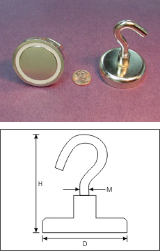

Same thing happened to my buddy building a RV-8. His solution was to go down to Home Depot's Aviation aisle and pickup a "Leading Edge Bucking Bar Removal Magnet". If you can't find one of those, a normal magnet should work fine. Get a small one and tie/duct tape it to to a string and go fishin'!

I have these small polished rare earth magnets that I could send you one which is ½ inch in diameter and about an inch long can easily pick up all of my steel bucking bars.
Put a string on it and wrap it with tape and go fishing. Might work

Brett, one last thing if the bucking bar is Tungsten you may have more difficulty with the magenet. My rare earth magenets will barely lift one edge of a small tungsten bar. They work fine on even the largest steel bucking bar. Tungsten does not seem to have the same magenetic properties as steel

BTW, I took yo'alls advice and ordered one of these puppies with 270lbs of pull force. This should work!

As far as accessibility, on the -9 spar, there are about 5 access holes starting on the tip end and extending to about where the tanks start. You need these access holes in order to rivet/buck the leading edge to the spar. The actual holes get smaller in diameter the further inward you go so the bar actually fell through about a 3" diameter access hole just inside the third "bay" from the end.

Just a follow-up. Yesterday I received my super-duper Nano-magnet and tied it to a string and a stick. The magnet "snapped" the bucking bar and removing it was a non-event.
