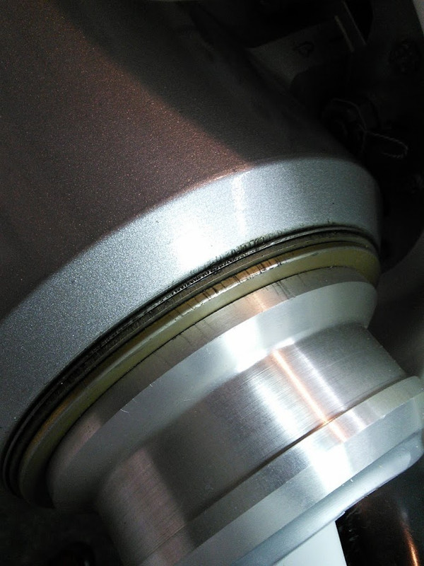

at 700 hrs my WW200 was throwing grease, so I had it serviced and that took care of it. the prop now has 1188 hrs and is doing fine, not throwing grease. when I serviced the prop I also changed to a Jhostrol gov that is more stable than my old MT. I am hoping to go well beyond 700 hrs on this service interval. I really like the Mccauley prop hub on the WW200. I like its mechanical design. the WW backplate and spinner are epoxy carbon fiber and have been perfect.
this is what the prop looked like when it was throwing grease at 700 hrs. very small grease streamlines at the hub making grease spots on the right-hand side of the canopy. I ran across these photo's as I was cleaning my computer and thought I would post them before deleting.
