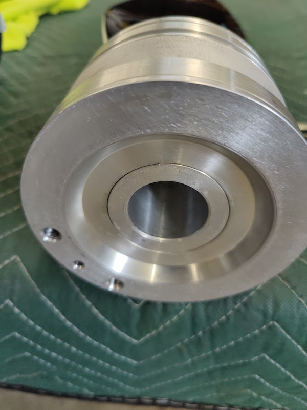

200RV inspection... some galling on a couple of surfaces on the hub but it was deemed acceptable. I didn't post photos of the galling to protect the innocent. I was not concerned about the location of the galling from a stress perspective. the blades and the blade hubs looked good. there are a lot of moving parts associated with a constant speed prop. keep them serviced and lubed for maximum life. do I still believe I can take this prop to 5000 hours, yep.
I was losing some of the tightening shims on one side prior to servicing. I believe this is because I really worked the prop one winter day at -25C. lesson learned... :)

well, 100 hrs since JDW service, at 1300+ hours, my Whirlwind 200RV has been perfect. upon disassembly and inspection at 1200 hrs, the parts were well within tolerance and appeared to be almost pristine. I believe this prop may last the life of the aircraft. time will tell.
there was a slight galling on one hub surface that Jay polished out. when I saw his polish work, I knew that he knows his business. it was done just right. not too much with just the right blending.
