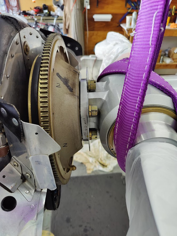

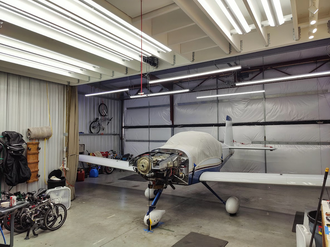

removal with the winch was very easy. I have done it by hand several times but this is much better. the winch was very inexpensive. removed a total of about 50 grams of lead from the crank (we need to get rid of that shit). constant speed props are a hassle, but it saved my life and my wife's one time at 42B, so I am stuck with them. WW RV200 = massive hub and light weight blades. keep them serviced and they should last for a very long time. hopefully, I can take these one to 5000 hours.
