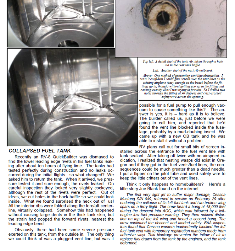

third issue RVator 2008 - collapsed fuel tank
Posts: 2120
I didn't know this ....

Re: third issue RVator 2008 - collapsed fuel tank
Post by rockwoodrv9a »
Wow. It is hard to believe that much pressure could be in the tank. I will make sure and check my vents next time Im at the airport. If we ever get some good weather, I may even fly again! I am starting to understand the migration to the south in the winter!
