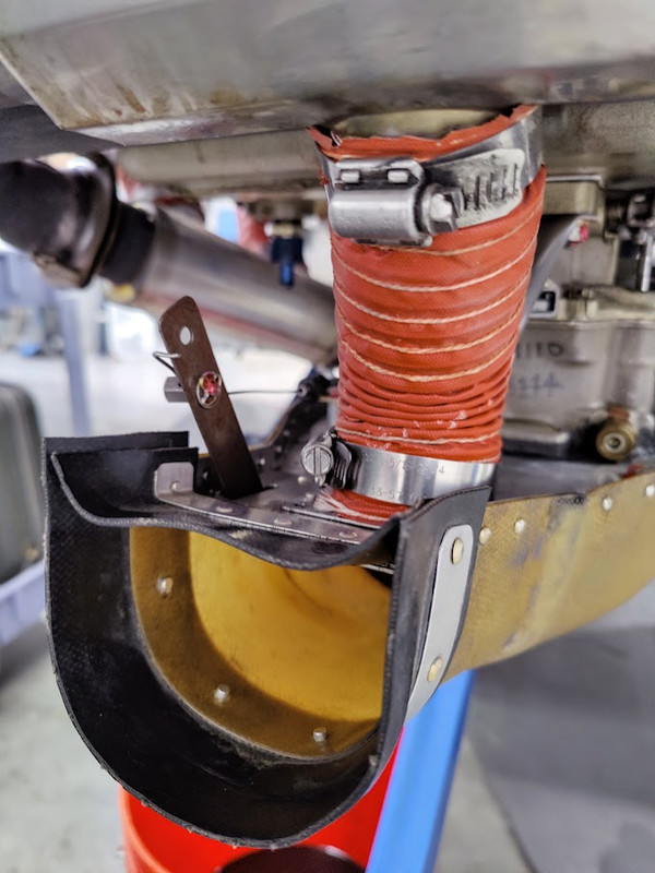

over 1100 hrs and original carb heat cable, lever bug attachment and airbox inlet seal are in perfect condition. when I pull the carb heat ON, I get 40 RPM drop during runup.
applied AT-205 (once a year) to the black rubber airbox inlet seal and also the baffle seals, all original. they just keep going. I change the air filter each 500 hrs.
